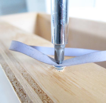

In addition to @Brad's Penetrene tip, try using a rubber band for grip.
