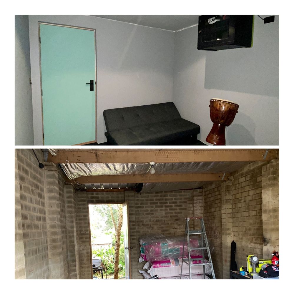

We brought our first home this year. My husband needed an office as he works from home full time.
So our first project was to convert this old 30-year-old run-down garage into a office space that was comfortable for him to work.
This has by far been the hardest thing we have ever done while juggling two kids, however we are extremely proud

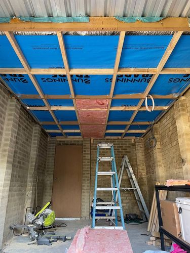

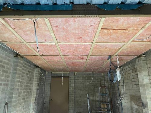

Frame the walls  and ceiling after a lot of measuring and planning.
Step 2
Added the Insulation silverwrap and then pink batts for ceiling and earthwool.

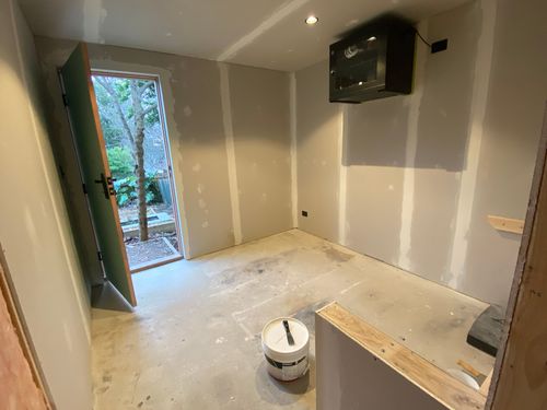

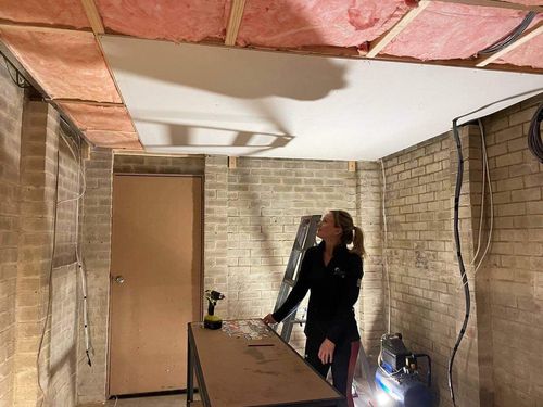

Step 3
Drywall the ceiling to begin with, after this we began framing walls before dry walling the lot.
Step 4
Plaster the dry wall - sand, plaster again.

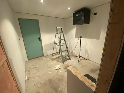

Step 5
Undercoat the drywall before your final coats of paint.
Sand between coats.

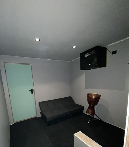

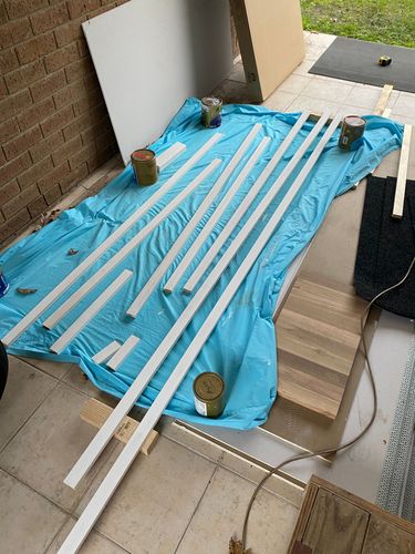

Now we look forward to having a office / hubbys man cave, separate from the house....
Skirtings underway then painting the door and this project will be 100% done!!

@christinamack88 , small steps at first, fantastic end result , you will prob find you you will tweek it as you go
Home Improvement Guru
Re: Turning a 30Y/0 garage into a office/mancave
Hi @christinamack88
Great result. 👍
What's happening in the ceiling corners? Is there cornice I can't see?
Welcome to the Bunnings Workshop community @christinamack88. It's sensational to have you join us, and many thanks for sharing your wonderful project.
Wow, what an incredible undertaking! Converting a garage into a functional and stylish office/mancave is no small feat, especially with the added challenges of juggling two kids. It's evident that you took the time to ensure every aspect was done right, resulting in a beautifully finished office/mancave. I can only imagine how excited your husband must be to have a dedicated workspace that provides both comfort and functionality.
Any plans for adding artwork, plants, or personal mementos to give the office/mancave a personal touch?
Terrific work, and well done!
Thank you. I have a massive new appreciation for builders. Painters. Plasterers and any sort of tradies. These jobs are hard work. :smile:
Thanks so much,
Im painting them currently, just did the undercoats. They will go on, along with a desk this week :smile:
