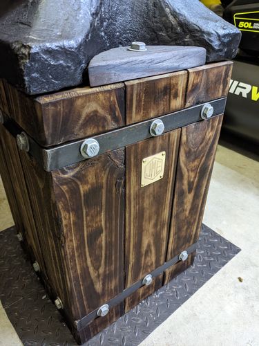

A couple of weeks ago, I picked up a little anvil for a very reasonable price off Facebook Marketplace. Now while I had no immediate need for an anvil in the garage, if you love tools, you probably love anvils too
Naturally an anvil needs to sit on a sturdy base and I didn't just want to settle for the old tree stump solution. I wanted something epic, preferably medieval looking with a mix of charred wood and bare steel.
So I started off with a 100x100x2400 timber post that I cut in 4 and glued together to create the 200x200x600 blank to work from. I used a power planer to get the sides relatively flush without completely ruining it's rugged looks, and also threw a bevel on the edges while I was at it. I traced the anvil's footprint and used my router to drop it by about 10mm so that the anvil sat nice and snug and couldn't slide around. I also used the router to create 2x 25x3mm channels around the base, 150mm from the top and bottom ends.
Once I was happy with the shape and size, I used a blowtorch to char the exterior and really bring out the wood grain, followed by a quick Scotchbrite scuffing to blend it nicely. I sealed the charred base with two layers of boiled Linseed oil.
Finally, I created the 2x metal straps that fit snugly in the channels I had milled, welded the ends and drove 16x 45mm coach screws through it to bring it all together. Overall, I'm super happy with the outcome. The last step will be to add the tool holder to the top and secure the anvil with some brackets that I'm yet to make ![]()

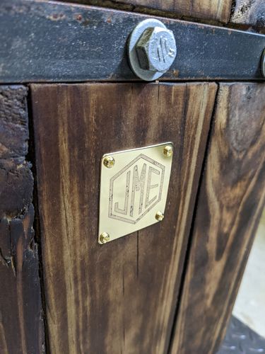

Quickly etched a little brass plaque last night and affixed it to the base.
(Pro tip: The back of that plaque says "NO Junk Mail" 😬)
Sure thing! It's super simple and requires very little in terms of special equipment or chemicals.
The first time I attempted etching in brass, I was convinced that I'd need to get hold of some Ferric Chloride or similar acid. I only managed to get Sulphuric Acid and Hydrogen Peroxide at the time and this did NOT work at all. It only stripped the zinc / tin from the brass and did nothing to the copper so it just became discoloured instead of etched.
I did a bit more research and found another article that suggested etching with electrolysis which turned out to be the winner in the end, only requiring salt water and an old, stupid car charger that doesn't apply any clever charge profile and just supplies 12V until you turn it off.
In short, I attached the positive wire to the brass plate I wanted to etch with only the logo exposed to the surrounding water, and the negative wire to a sacrificial piece of metal in the form of an old galvanized coach screw. Flipped it on for an hour and voila! Etched 👍🏻
Note that these little brass sign plates come covered with a lacquer to prevent oxidation, so give it a good sanding with a Scotch Brite pad before attempting to etch.

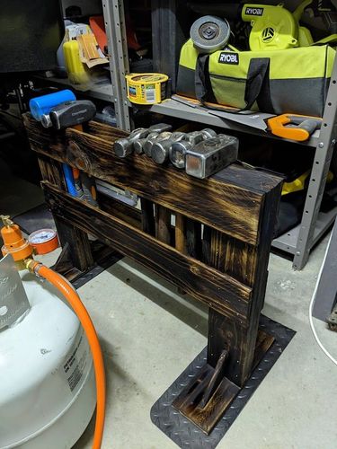

On top of that I am also in the process of making myself a hammer rack to go with my anvil, because forging with hammers strewn haphazardly upon the garage floor turns out to be not ideal ![]()
Here's a little sneak peak of my progress so far. This one has been constructed from some left over pallet planks I had in the garage. It was constructed primarily to be functional and given that those planks are crooked as, I ended up spraying it with finishing nails until it behaved. Thankfully the charring and oiling hides my impatience a bit
It too will now receive 25mm flat bar straps on the ends, along with a rail for holding tongs and couple of places to store punches and drifts.
