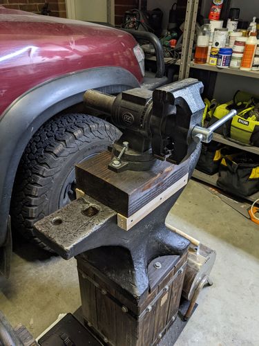

Made an improvement by adding some robust wings from 25mm x 3mm flat iron that offer the ability to hold fire bricks and tools, and also manufactured some mounts for tying the whole thing. Together it's so stable at the moment.
Also, in other news, I found that mounting my vice to my anvil when I'm not using it works fairly well I made some tracks to keep it centred and a square bit that fits in the hardy hole to keep it from sliding around.

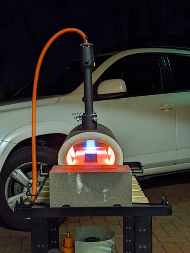

And here are some happy flames to finish it off
Re: Making an anvil base
How close is the car to the forge Marti?
Has the insulation been hardened?
Hi @Brad,
The car is parked outside the garage parallel to the garage door, well outside of the forge's exhaust heat 👍🏻
The forge insulation is a 1" layer of kaowool saturated and covered with refractory cement.

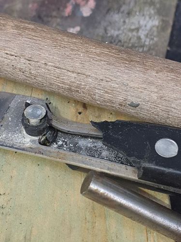

I was surprised at that until I tried to punch out the slotted metal piece - proved to be just a aluminium rivet and the plastic (which I thought would be solid?) shattered in all directions. Even the handle area is not solid metal - slotted. Poor knife design?
