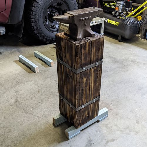

A couple of weeks ago, I picked up a little anvil for a very reasonable price off Facebook Marketplace. Now while I had no immediate need for an anvil in the garage, if you love tools, you probably love anvils too
Naturally an anvil needs to sit on a sturdy base and I didn't just want to settle for the old tree stump solution. I wanted something epic, preferably medieval looking with a mix of charred wood and bare steel.
So I started off with a 100x100x2400 timber post that I cut in 4 and glued together to create the 200x200x600 blank to work from. I used a power planer to get the sides relatively flush without completely ruining it's rugged looks, and also threw a bevel on the edges while I was at it. I traced the anvil's footprint and used my router to drop it by about 10mm so that the anvil sat nice and snug and couldn't slide around. I also used the router to create 2x 25x3mm channels around the base, 150mm from the top and bottom ends.
Once I was happy with the shape and size, I used a blowtorch to char the exterior and really bring out the wood grain, followed by a quick Scotchbrite scuffing to blend it nicely. I sealed the charred base with two layers of boiled Linseed oil.
Finally, I created the 2x metal straps that fit snugly in the channels I had milled, welded the ends and drove 16x 45mm coach screws through it to bring it all together. Overall, I'm super happy with the outcome. The last step will be to add the tool holder to the top and secure the anvil with some brackets that I'm yet to make
PS: Below you will see the welds I did where the ends of the flatbar met. I welded this in place because the strap sits in a channel and could not be fitted over otherwise. I did these with a little Ozito gasless MIG I bought last week: The new one, where the feed and voltage are both adjustable rather than just the feed rate. It works like a charm

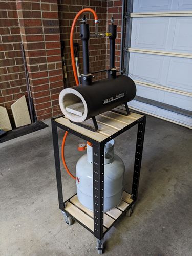

Finally got around to building my forge trolley today from some scrap metal and wood I had laying around the garage. Also finished the spool of wire that came with my little Ozito gasless mig. That thing is such a joy to use.
