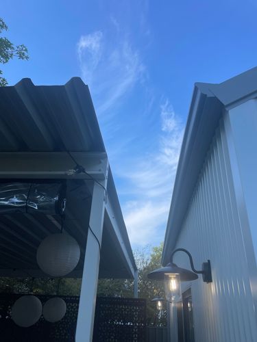

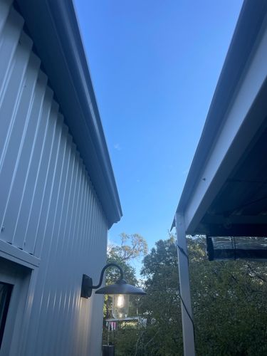

I am looking to span a gap between two steel structures - about 500mm apart.
Both structures are made of steel.
A short-stay with corrugated cladding to steel frame and a patio with trim deck to steel
frame.
im wanting to bridge the gap between the two with clear polycarbonate sheets for rain protection.
I have lengths of leftover light steel purlins and battens which Im planning to attach to the roof of each structure and then attach polycarbonate. There's enough fall for water to flow onto the patio roofing.
Question - would the new cover be light enough to screw the battens lengths to the steel roof sheeting - or should I screw thru to the purlin or rafter underneath?

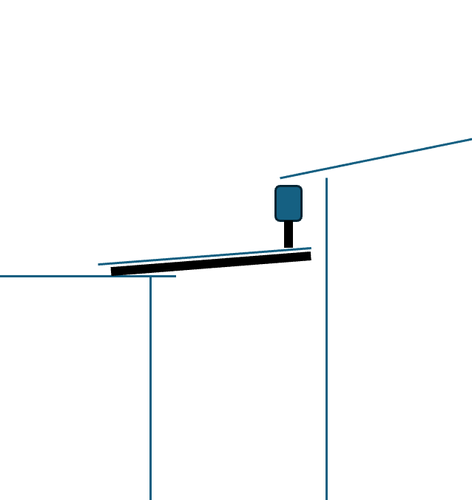

Hi @SeanWA
I would install a custom fabricated steel frame tied to the left hand roof counter-levered across to but not connected to the right structure just under its guttering. To @JacobZ point these structures should not be connected due to independent movement. Downpipe/s from the right structure guttering to the counter levered roof if required to assist with water run off.
Nailbag
