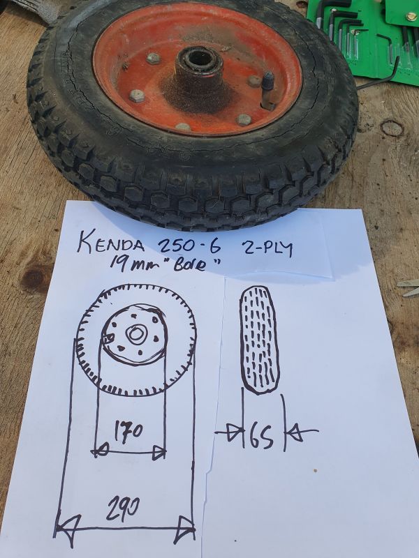

"They're 10" wheels.
Outside tyre diameter is around 290mm
Axle is 19mm diameter.
Those Sherlock wheels would fit?"

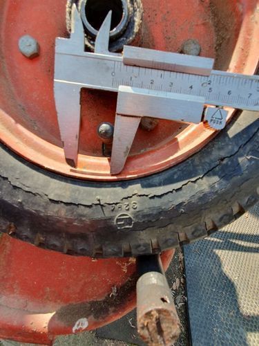

I'm wondering if my cracked tyres are contributing to the overall 290mm outer tyre diameter?

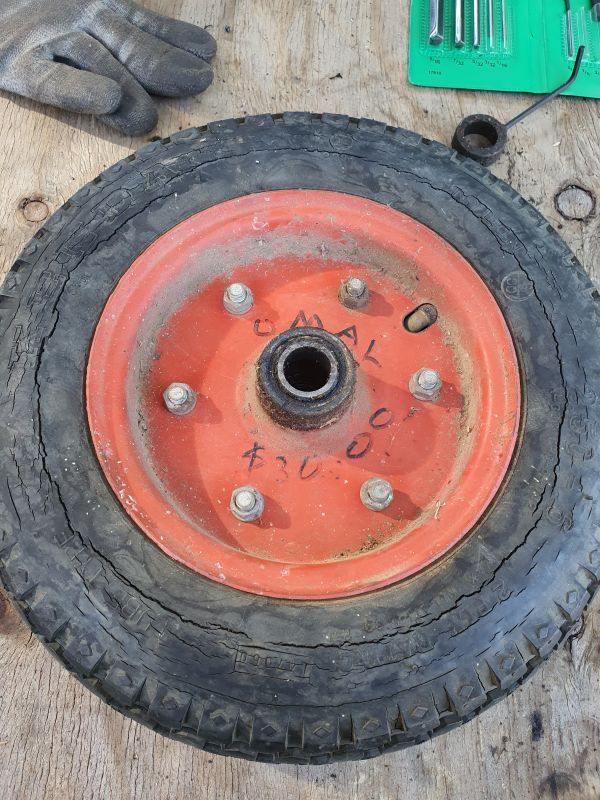

Rough estimate is they would be around 40 years old.
Hand made welded trolley by my father.
The locking ring grub screw - is most definitely imperial  - 1/8" hex.
See what ya think mate.
Cheers!
Fissures appearing...Fissures appearing...

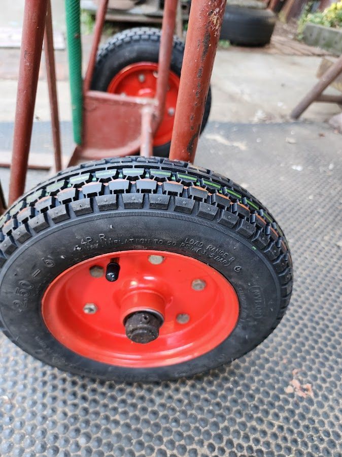

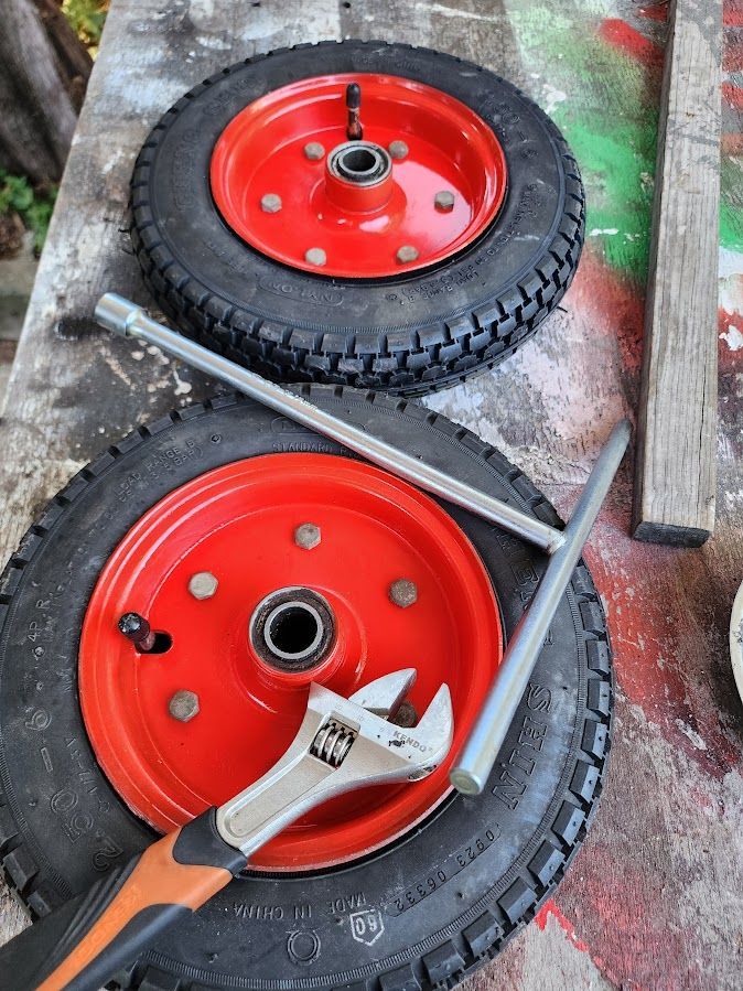

Long time coming, but eventually I took a wheel to a tyre specialist yesterday.
Got the replacement tyres and tubes today and I cleaned and painted the rims.
They are now around 280 mm in diameter with 40 psi.
A vast improvement on the old wheels.
Cheers.
