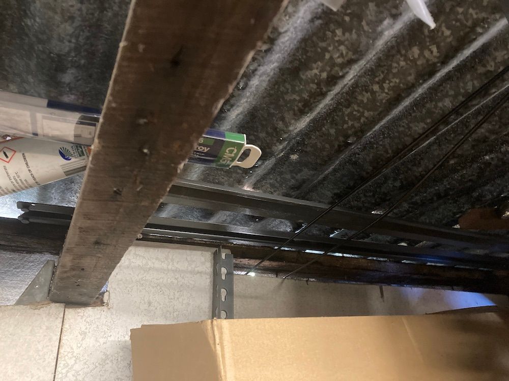

I have a 50+ year old shed that's a tin box. It's 10' by 20' by 7.2' high (sorry for the imperial, but the dimensions suddenly made sense when I switched measurements). It's hardwood framed, corrugated iron with a flat roof. It's rusted and getting pretty leaky and all my stuff is getting ruined. I want to fix that.
I'm not much of a builder, but I also can't afford a proper builder/roofer, or find one who isn't booked up for the next 12 months. So I'm looking for something I can achieve myself, and advice.

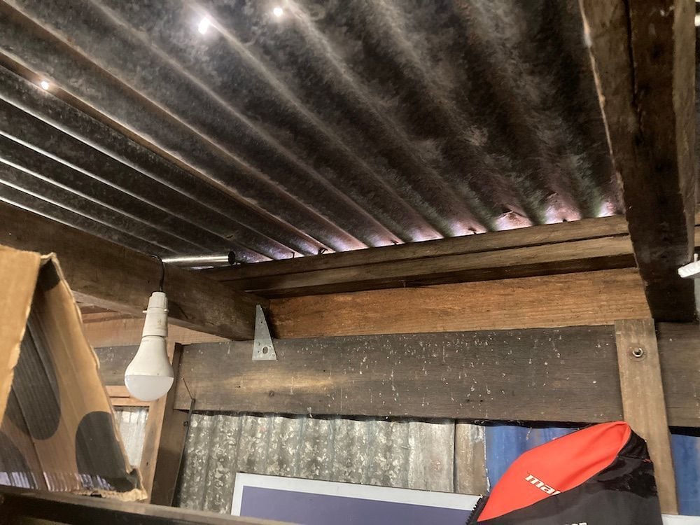

The corro iron roof is pretty much buggered and suffers from condensation. It couldn't have more than a couple of degree of drop on it and the eaves are a maximum of 6" so when it's bucketting down the rain still just creeps back under via capillary action. There's no gutters. The beams are all super tough - can't put a nail in them, and it's broken a couple of drill bits trying to affix lights. Structurally, it's a brick.
The lengthways boards that the roof is nailed on to are not hardwood and are super rotten and need to go. The thick beams that these boards are on are the hardwood and are in great condition.
I'd like a bit more headroom at least to store all the posts and bits and bobs and thought a shallow triangle shape would be the go.

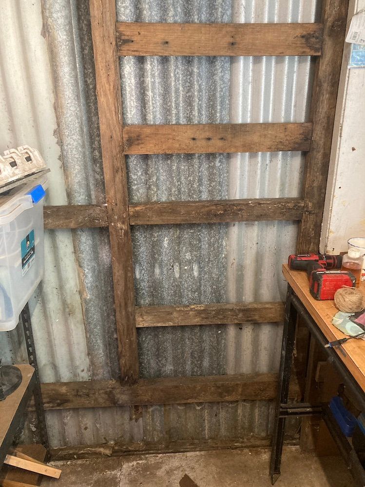

The wall beams are all hardwood and are in pretty good nick. The bottom rail doesn't touch the concrete at all (there's a gap) and the corner posts are all solid. So I'm pretty sure it would hold the extra weight of a peaked roof.
What are my options for the roof? I was thinking of framing up some trusses out of structural pine. How do I 'connect' them to the framing as it is shown in the pictures?
