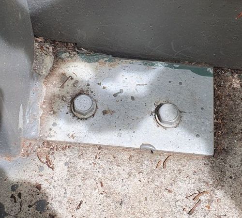

I did this around 12 years ago. Both 10mm concrete bolt holes were drilled approximately 35 mm from the edge of the concrete. It's rubbish concrete that I laid 5 years previously.
I was 99.5% certain the concrete would split/chip/crack.
Amazingly - it survived.

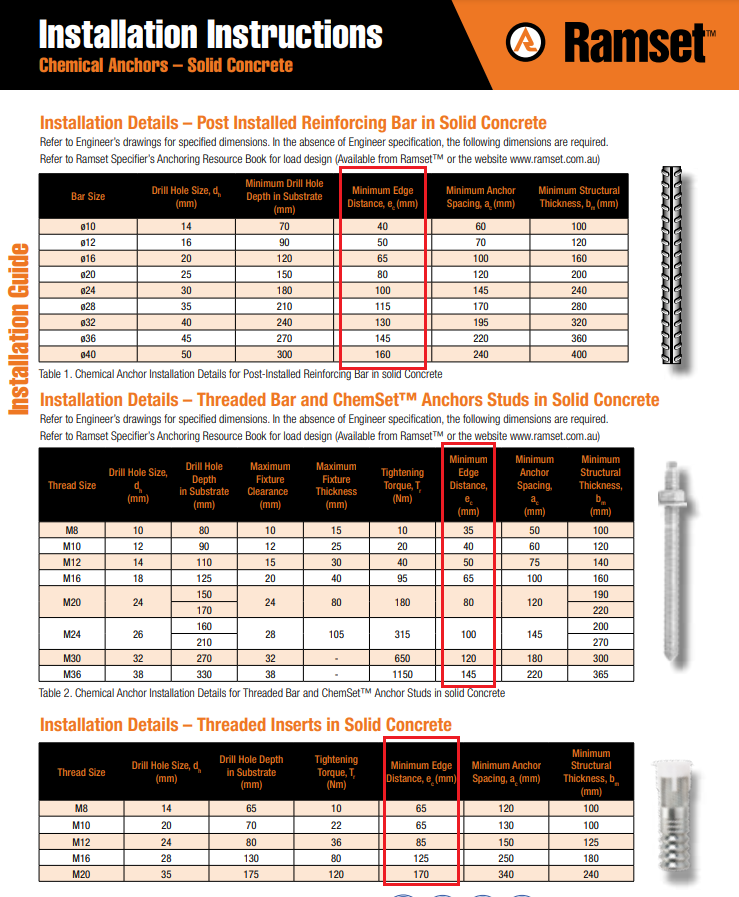

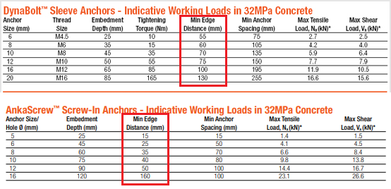

Here are the specifications from Ramset on minimum edge spacing. Using Ankascrews or chemical adhesives over Dynabolts gives more flexibility when fixing close to the edge of the slab. These min distances are specified so that the fixings meet their designed load ratings.
