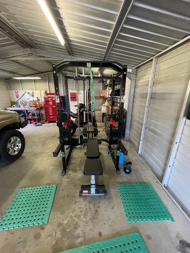

Hi everyone.
I have a 10 year old Titan shed which is 9m x 6m in size. It gets awfully hot in QLD summers and I'm now deciding to insulate the walls and roof. I use my garage shed as a workshop for my 4x4 and also for home gym/man-cave area. So I am spending a lot of time in there. Currently it is just metal sheeting and I am asking the question regarding how to fix insulation to the metal walls and ceiling to prevent the insulation sheets coming off. String? Wire? are there particular fasteners available for this kind of retrofit? I'm looking at using either Foilboard 20 x 2400 x 1200mm Ultra 20 Insulation or Ametalin 1500mm x 20m ThermalLiner Roof and Wall Shed Insulation. I think the rigid boards might be the better option for me?
Any advice on fixing insulation to the walls and roof would be greatly appreciated.
Images attached of interior of my shed.

It has been a while since I made this post. I am going to order the 25mm thick boards for my garage this weekend.
My point of confusion is how I maintain the boards in position on the ceiling of my shed with the screws/plates? I dont want to drill into the colorbond roof. My beams are less than 1200mm wide so that fits with what your suggestion above is about an easy install. Advice on the screw/plates and fixing the boards in place to my already built shed as shown in my initial post photo attachment. Thanks :smile:

@MitchellMc Im assuming attaching some timber battens / planks intermittently and attaching the boards to those is the process but I'm not entirely sure. Your initial guidance recommended the screw plates... Thanks :smile:
Re: How to install insulation in my Titan Shed walls and ceiling?
Hi @denk
Installing a timber batten framing makes it easier to install the board to your ceiling they also provide an air gap between your Colorbond roof and the foil board. The screw plates actually hold the board in place, the wide plastic washer prevents the board from being accidentally pulled off. Let me tag @MitchellMc just in case he has anything else to add.

You can either use the Standard Fastener in the face of the steel rafters or the Flexifast Clip into the side of the beams to secure the foilboard. You'll need to use self-tapping metal screws of the correct length instead of nails.
