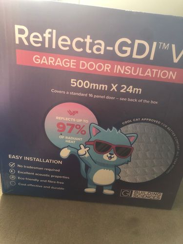

Hi @MitchellMc I finally received my reflecta GDI V2 insulation will let you know how it goes putting it on the roller door and how well it works. Thanks for your advice
