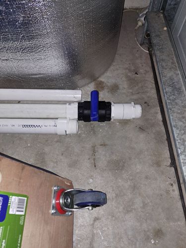

The installation is a dog water treadmill so there are 3 white PVC pressure pipes that need to come out of the garage door (see photo) opening to dump water into the garden using a firehose:
1.  Filter backwash 40mm (used regularly, pool pump pressure but open end)
2.  Tank drain 50mm (rarely used, no pressure)
3.  Chamber drain 50mm (rarely used, no pressure)
I plan to cut an opening in one of the puppy pen panels and bolt some plywood on that I can route pipes though.
Thoughts:
1.   Bring all pipes through the plywood then cap unused ones
2.   Connect all pipes together in the garage with on/off valves on all to prevent cross contamination;  Does Bunnings have a 3 input / 1 output 40mm or 50mm PVC coupling?
3.   Use 40mm to 50mm adapters so all connections inside the garage are the same size
4.   Use a 40 or 50mm compression coupling to connect to a piece of PVC pipe hose clamped to a fire hose.  But, compression coupling isn't easily taken on and off.

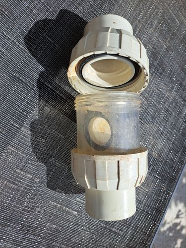

5.   Ideally, connections would be something easily screwed on/off like the attached flapper valve coupler i found in an old shed (see attached).  Does Bunnings have anything like this (no flapper valve needed)?
6.   Connections through the plywood would need to be tight to keep snakes out so no room for couplings to slide through unless sealed afterwards - could seal with duct tape after each setup.
7.   Snake barrier would be setup on days water treadmill is used and taken down afterwards
8.   A flexible hose is needed inside if connecting one pipe through the the barrier to different inside pipes.  Does Bunnings have a flexible 40mm or 50mm pipe?

Hi @Steve5,

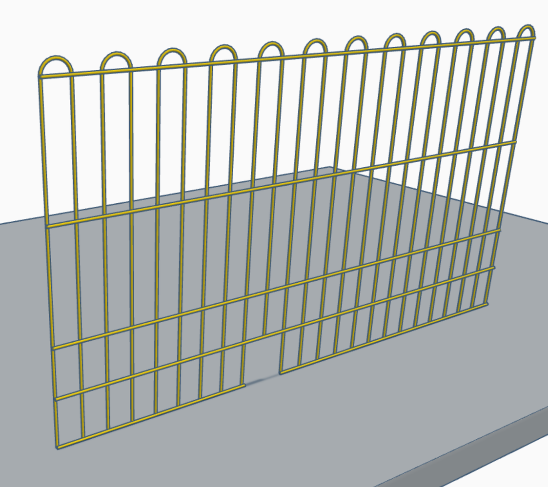

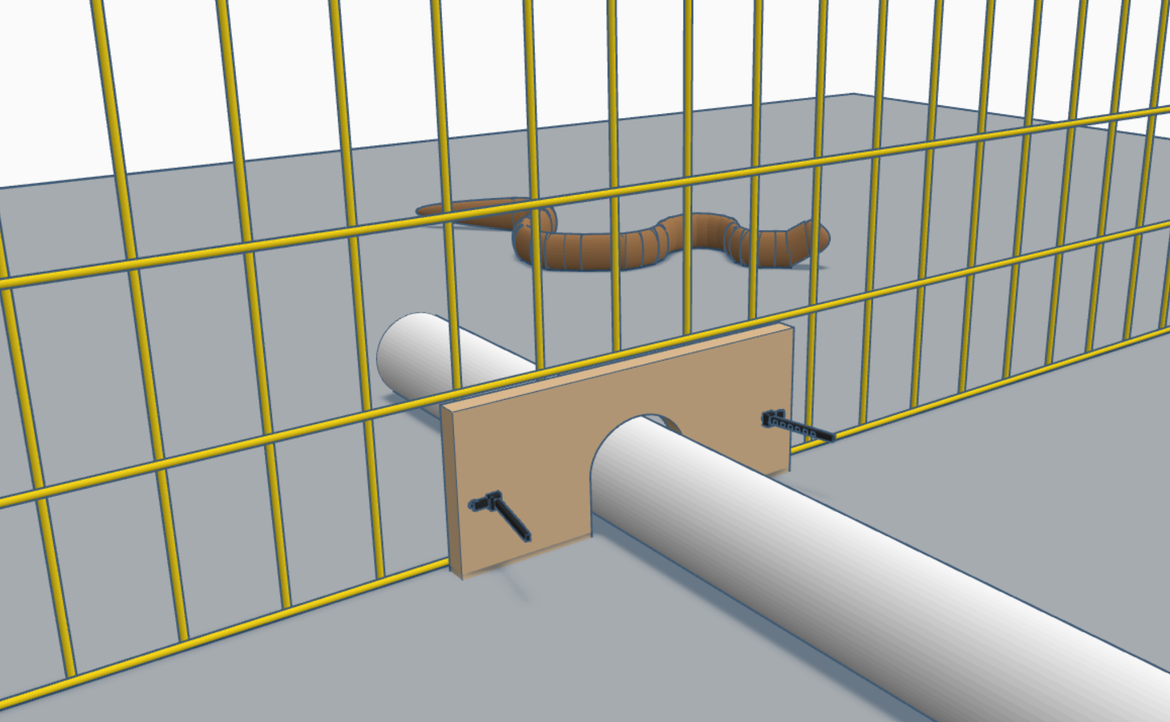

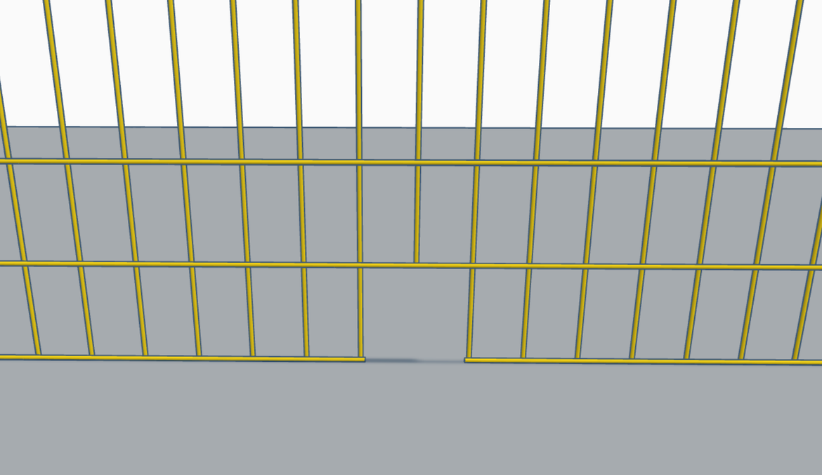

I like the idea of installing 40 or 50mm ball valves onto the pipes, so they can be isolated and then you'll only have to deal with one pipe. Can you have the plywood at the bottom of the cage and remove a wiring section there? That way, the cage could be lifted up and off the pipe, and there would be no need to disconnect the pipes, which sounds like a huge hassle. You could always have your system connected to the fire hose. Alternatively, you could have just a hole in the plywood instead of the cutout. The ply would sit on the pipe all the time, and when the gate was in place, you could connect it with cable ties. I've created the renderings below to illustrate.
There are no three-into-one connections, you'd need to do that with elbows on the two outer pipes facing the middle pipe and staggering their joins into it with two tee pieces. It would be easiest to convert all pipes to the same size first. This Holman 50mm PVC Compression / Coupling Repair could be used for your disconnect. It has a screw fitting similar to your coupler. We have this Abey 50mm PVC Flexible Pipe Joiner.

Good idea to keep the pipe on the ground and slot plywood over it.
I'll always need to disconnect the pipe when I close the garage door.
The flexible PVC pipe is great information, I can have 50mm pipe ends on all then use flexible pipe to connect to a fixed pipe in fence when needed.
Then on the outside I'll use a 50mm to 40mm reducer hose clamped to the firehose.

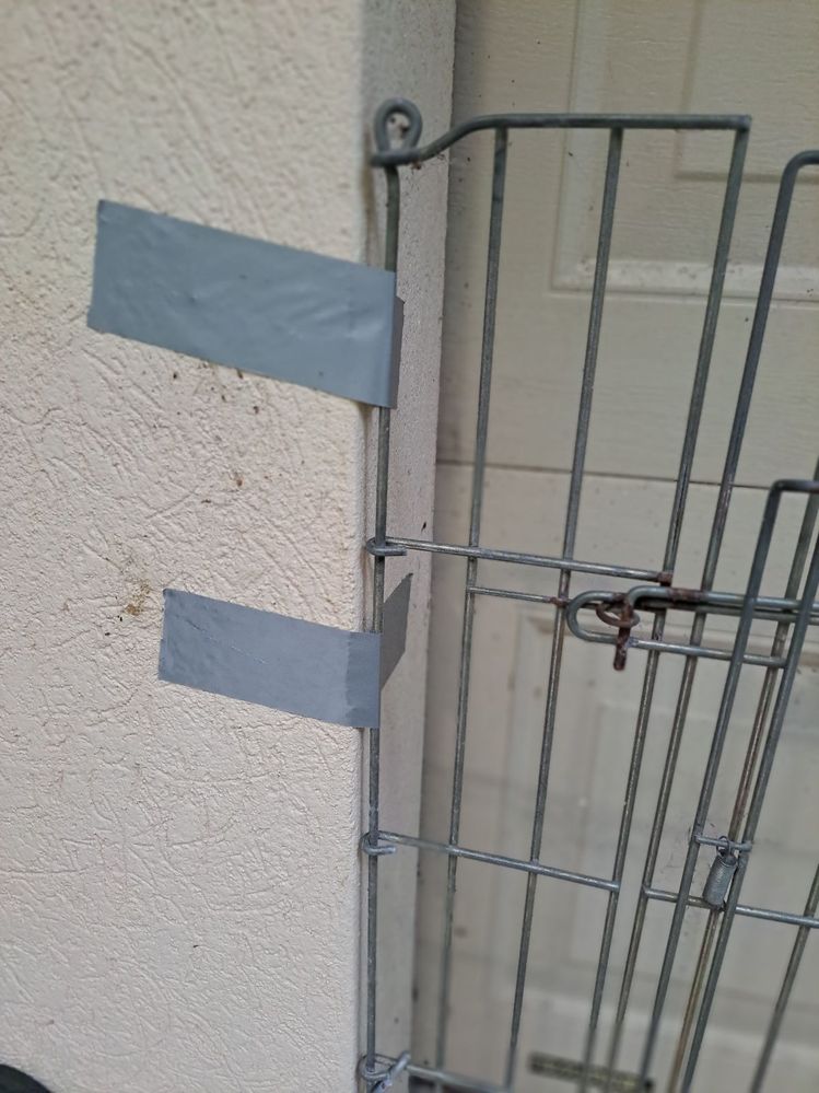

Hi Again,
I found an old dog fence that I may use that just fits.  It's only about 700mm high so probably good to get a taller one for climber snakes..
Can you advise any plastic clip that I can attach to the corner of the wall?  Plan was to drill a hole in the wall and use a plastic insert to screw a clip on, but not sure how to do this on the corner.
