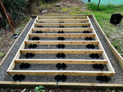

Ok done! Levelling all 27 blocks wasn't my idea of fun. I had raked and tamped the gravel about 20 times over the last couple of months and it was still off. Most were just raking a bit out and re-tamping but I did have to add some small shims made from sliters of treated joist offcuts to a few of them.
The next step is to add another screw to each joist (So they have 3 in each) and add some joist tape before putting the floor on.
Oh that's a point: Should I use joist tape on the joists and bitumen paint on the bottom of the flooring panels, or is that overkill?
Nice work @mikebarker!
Since this is not a deck where rain falls through it and hits the top of the deck joists, causing decay, I don't see the point in adding joist tape. However, I would be painting the bottom of the STRUCTAflor, as it will help prevent it from absorbing water from the moist environment after rain.

@MitchellMc it did not even occur to me that joist tape was for decking for that reason 🤦🏻♂️ I'll certainly do the bitumen paint on the floor though.

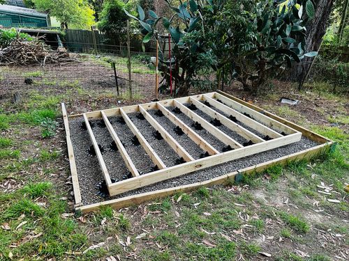

Evening all! My floor has ended up a touch out of square once I added all the joists in. I'm 13mm out 😑 - I've tried jostling it around but haven't been able to make it budge. My plan is to try and square it up more using the flooring sheets, i.e. squeeze it and then secure the floor, holding it in more in place. Sound like a plan? Anything more I can do?
Also, to get things level with the tricky gravel base I've used chocks of treated joists to raise a few of the feet up. This will be ok right? I figure the weight is distributed well enough there won't be a crazy amount of pressure on a single block.
I know non of this is ideal, I'm just keen to proceed with some sensible solutions that doesn't involve pulling things apart to get it perfect.
Approx 9mm chock of treated wood
Evening @mikebarker
Bugger 😕 Know that out of square feeling.
How heavy is the actuall outside square? (Just the four pieces) Maybe you could put the outside square together on the grass then move it over and get that level before adding in the timber joists and tuffblocks? That way you can meausre diagonally to make sure its staying square.
The gravel can be packed underneath once you have the frame right and the joists are down.
