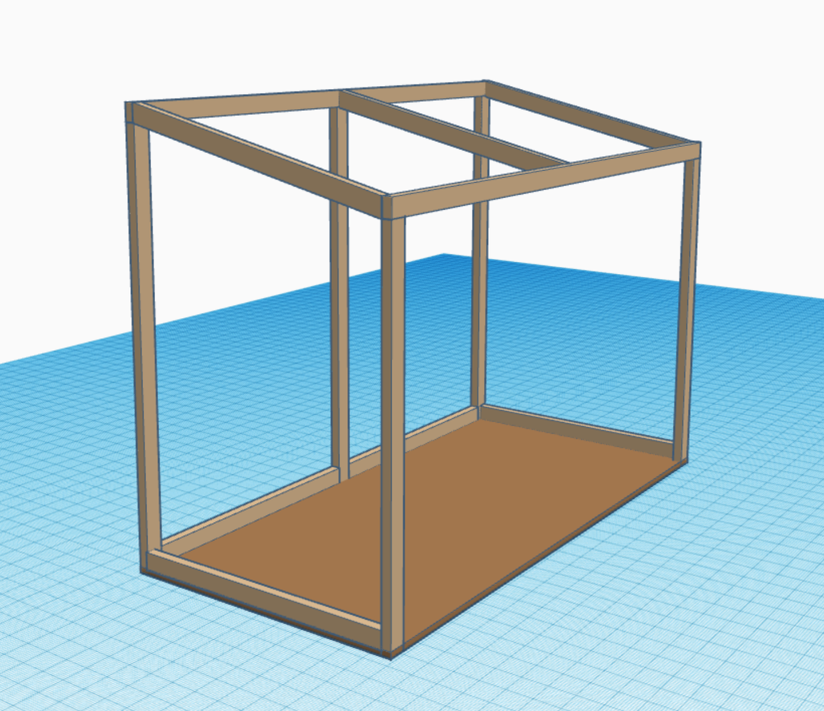

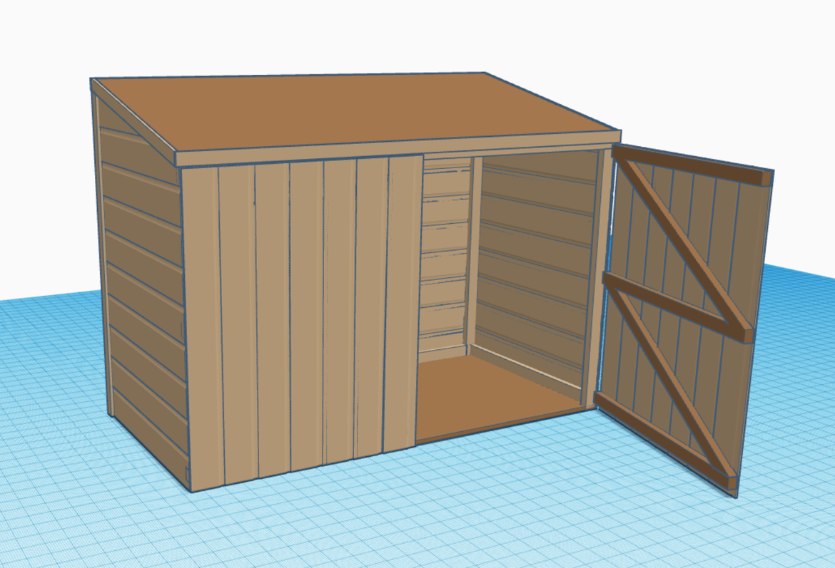

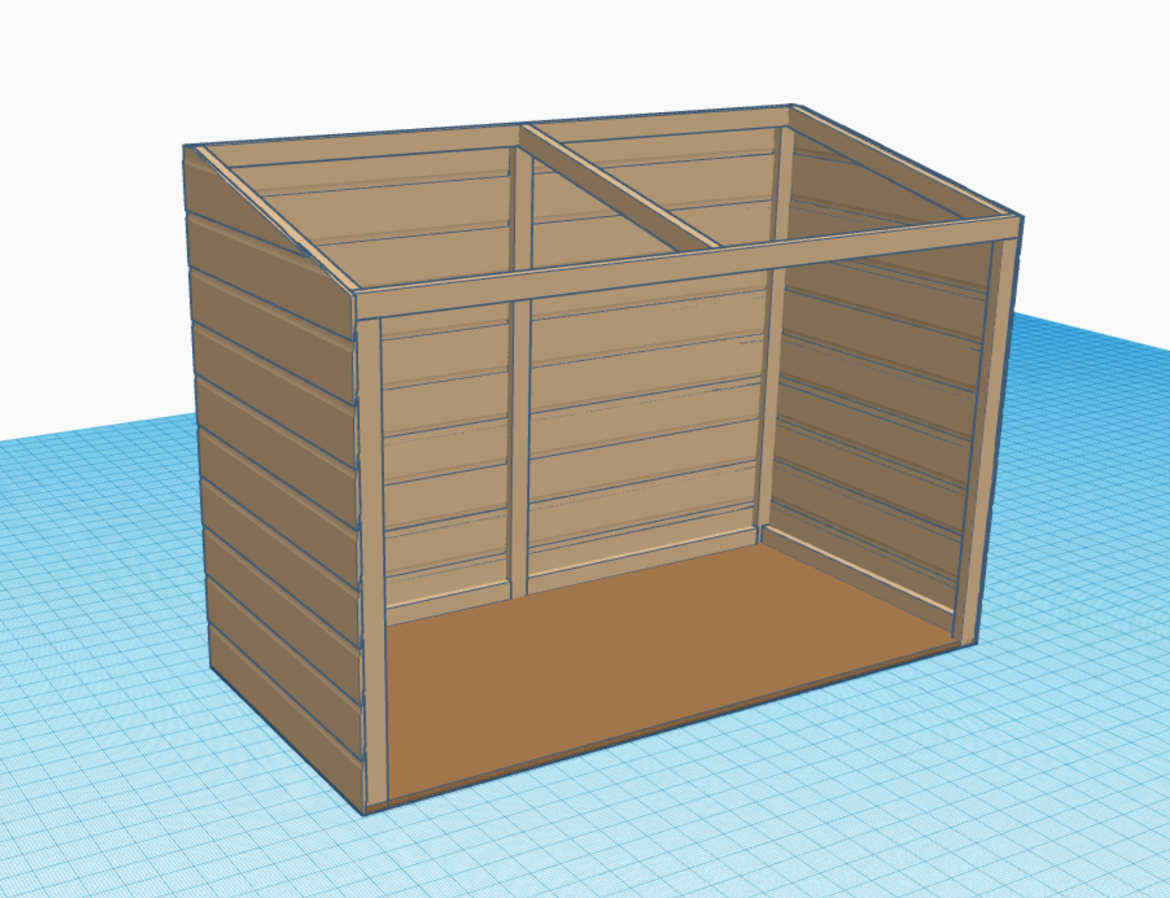

Hi @DaRobba,
I've had a go at breaking down your inspiration image into some renderings depicting the construction stages. I'd suggest using H3 treated 70 x 35mm Pine for the frame and cement cladding planks to cover the frame. Using a cement sheet for the roof would also be an effective solution. By using treated timber and cement-based products, you'll avoid many of the issues associated with termites and the need to treat the timber yourself for protection from the elements.
For connecting the frame pieces, I'd recommend using bugle screws, and the planks can be screwed to the frame with fibre cement screws.
