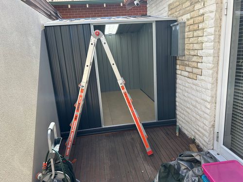

I am installing a garden shed at the corner of my block. Size occupies the whole space thus no access to go through.
query:
Whats the best way to add a door? No choice but to put wooden studs, cut out a door using a grinder, then make a door using wood timber frame and cover with the sheet that i cut out?

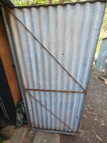

I was thinking a welded frame to fit, with small angle iron - corrugated iron cut to fit and pop-riveted in place. Bracing if required.
Pop-riveted or welded hinges to the shed.
