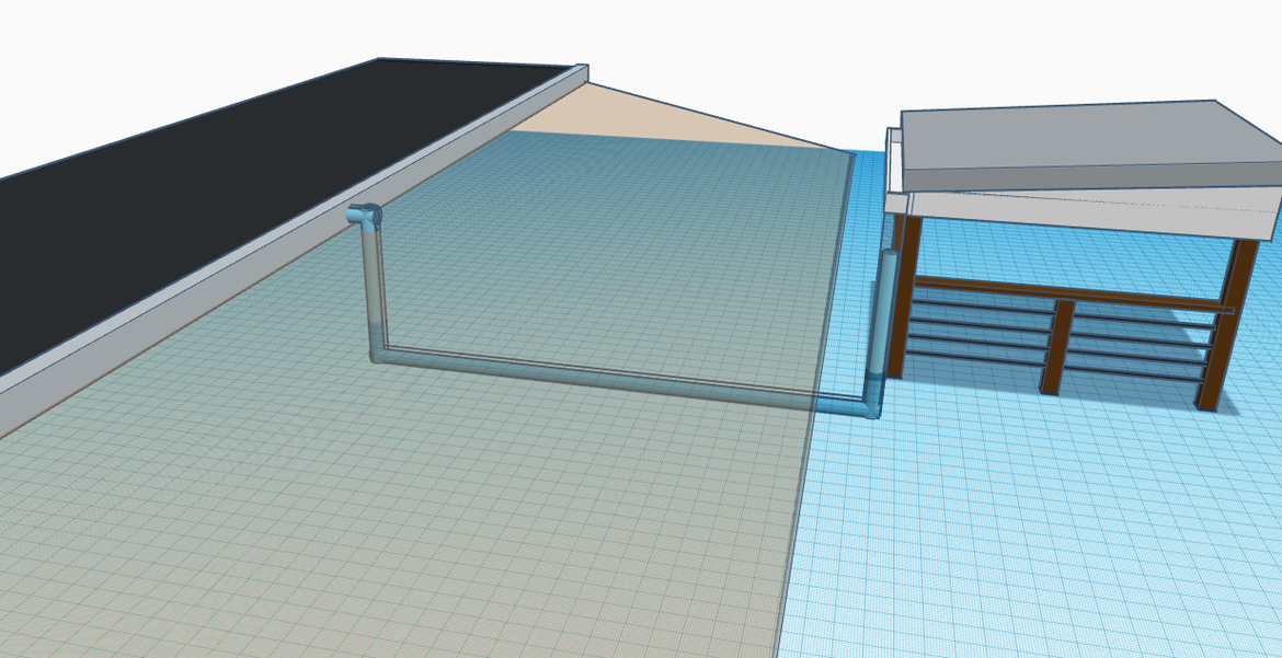

The rendering I've put together would be just about the limits of a charged system where the street is just below the gutter. In an ideal world, your stormwater would run downhill into the main collection line, but sometimes, as is the case with steep blocks, that isn't possible. Apparently, most councils prefer a charged system over a pumped system and will give a certain amount of leniency to alter the council strip, allowing the installation if the only other option is a pumped system. The issue with pumped systems is that in the event of a massive storm, power goes out reasonably frequently. It might only be once a year or every two years, but in those events, pumped systems fail and flood properties.
Thank you @Bluetooth and @MitchellMc for the excellent explanation and for the diagram. That makes sense as a potential solution for the overflow.

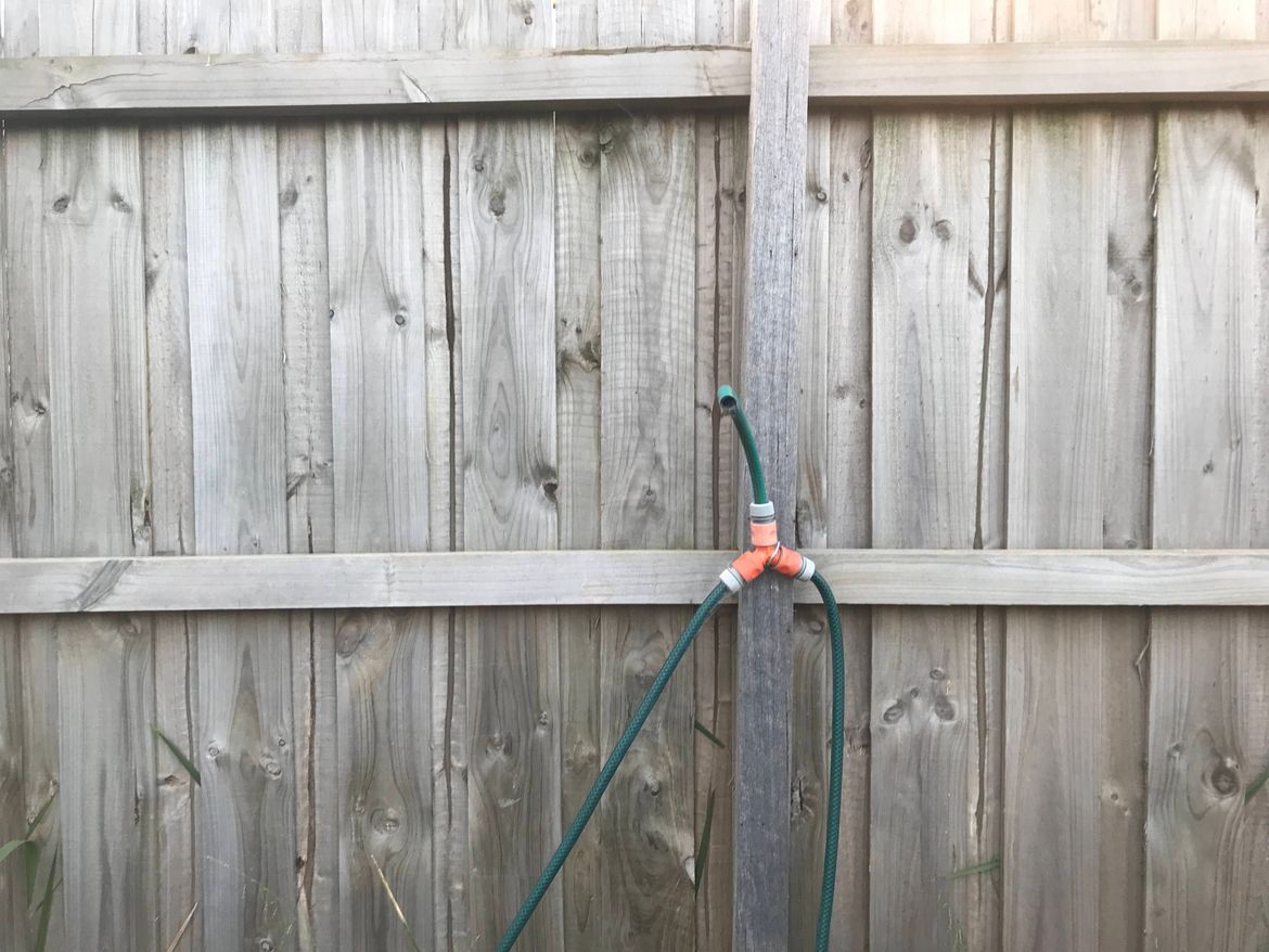

I have a similar problem with too much water coming off the garage roof that can't be fed to the house drain. I have them feeding into a tank. I keep the tank half full by feeding water from the tank tap to the trees in the paddock over the back fence via a hose. Halfway along the hose, it hangs on a hook on the fence, and has a hole in it to stop it siphoning. When the water level falls to the height of the hook, it slops flowing. So the tank is half full and can catch a big downpour and let it out slowly.

This is the hose arrangement. It doesn't just have a hole, it has a short vertical section off it. That's so a full tank won't have water spurting out the hole onto the fence.

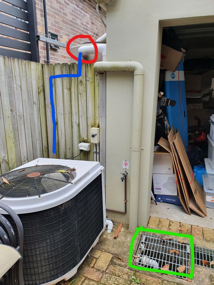

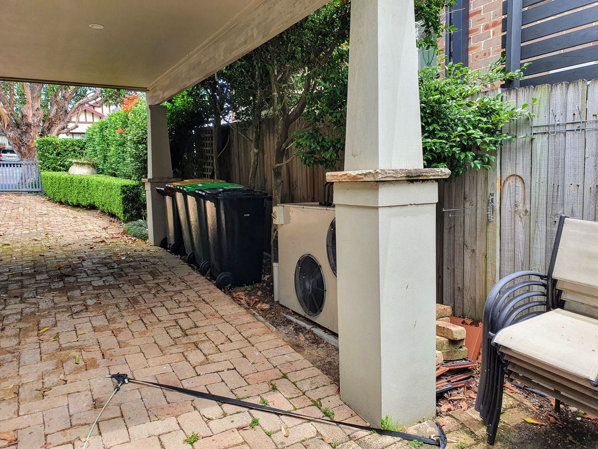

Hey @MitchellMc That drawing looks pretty good! In my case, the source would actually be the overflow from my rainwater tank (red circle in photo #1). You can see that it currently drains into the pit at the front of the garage (green square in photo #1), so when the tanks are full, and its raining hard, there is a huge amount of water that goes into the pit, and sometimes floods the garage.The sump pump moves the water along the fence to the top of the driveway, and into a pit which drains out into the street. You can just see a little of the pvc sump pump pipe next to the bins in the photo #2.
Now I think the best solution is to run a new 90mm pvc stormwater pipe from the top of the rainwater tank down (blue line in the photo) and along the fenceline at ground level to the front of the property to drain into the existing pit. That way it would flow to the street, without needing to be pumped up the hill. The system would need to be charged, I reckon. I don't plan to bury it, as it will not be visible since its behind hedges for 90% of the distance.
Any thoughts on this idea? After watching a few Youtube videos, I think I should use T-joins instead of elbows near the bottom of the charged system, for access in case i need to clean out debris.
