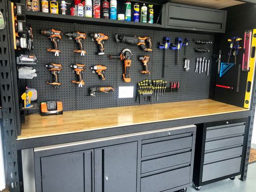

- The shelving is the Rack It 1000kg which we adjusted to our heights then used FJ Laminated tops as the bench.
- To hang the cleaning tools on the wall, the Oates 5 Handle Storage Holder was used. I just trimmed it down with the grinder to fit our space.
- For the peg boards, we used the 900x450 Pinnacle ones. Cut them down slightly to fit in our space, screwed them off to ply board that we screwed to the racking and placed a support bar at the back of the ply also onto the racking.

I've had a look at the products used, and it appears that the following list should provide most of what you need. Hopefully, @lcooksey88 might be able to run her eyes over my list to double-check that I've covered everything and that they are the same products she's used.

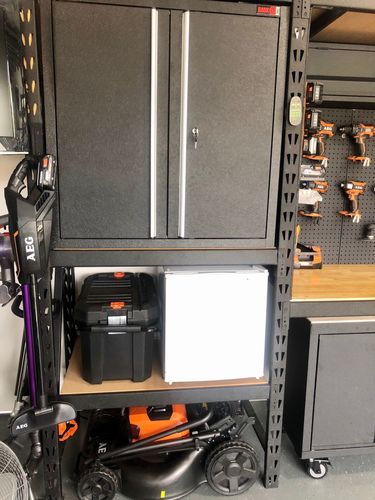

- Rack It 1000kg 1938 x 2135 x 645mm 3 Wire Shelf Starter Kit, two Rack It 1000kg 897mm MDF Shelves and four Rack It 1000KG Shelf Support Braces. These additional pieces allow you to change the wire shelf at the top to MDF.
- A Rack It 1000kg 2135mm Upright, six Rack It 1000kg 972mm Beams, three Rack It 1000kg 897mm MDF Shelves and six Rack It 1000KG Shelf Support Braces. These are used to create the left-hand side shelving.
- Five pieces of Pinnacle 900 x 450mm Matte Black Metal Pegboard
- Laminated timber panel. This is used as the work surface.
