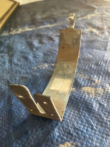

Been looking at Guttering on your website and noticed they are in sections around 3 metres ,,, but my question is how do join 2 peiices that meet in middle..? Is it the expansion parts or the joiners ? And is the part I’ve sent photo of a joiner cause the look similar

What you have there is an external bracket, and they are used to hold the gutter to the fascia. You'll place one of these directly over the joined section for additional support.
