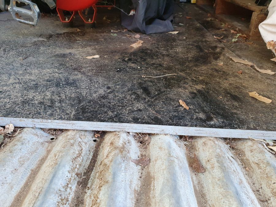

This is something I tried early last year - and yes, I admit, it's a cheap and nasty alternative, but so far it's worked.
It's a covered area that once upon a time was my three son's sandpit. All grown up - I wanted to use the area to store some equipment.
I kept the sand - leveled it.
Put down second hand corrugated iron.
On that I placed those laminated sheets (name?) from Bunnings. Memory thinks they were $70 for a 2400 mm X 1200 mm sheet.
At first I thought it wouldn't work, but as I walked over it and loaded stuff on, it 'settled' into the sand and became very stable. The troughs in the corrugated iron, in the sand, seem to have excellent holding power.
An area is exposed to the elements and so far - so good. Can't see why it wouldn't work in a small shed?
Anyway, just a thought.
