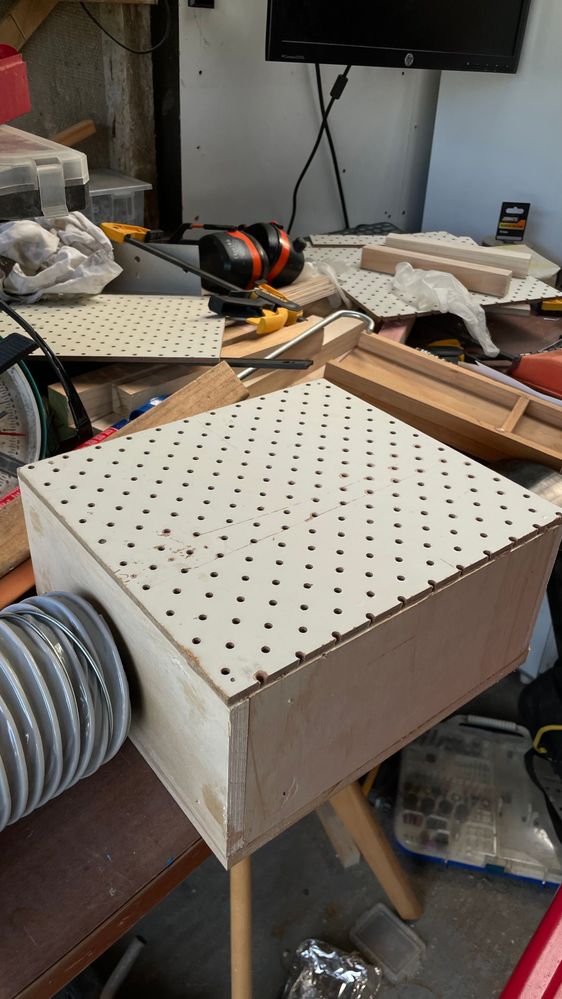

4/5Measure the diameter of your vacuum hose and cut a hole in the side that size.
Mine wasn’t quite the right size so I ended up putting some little pieces of wood around to support hose.

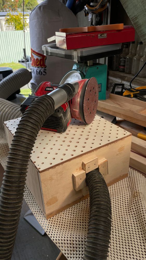

I also had a spare shop vac hose which allowed me to plug my sander in. This meant I had to make another hole on the other side for the hose.

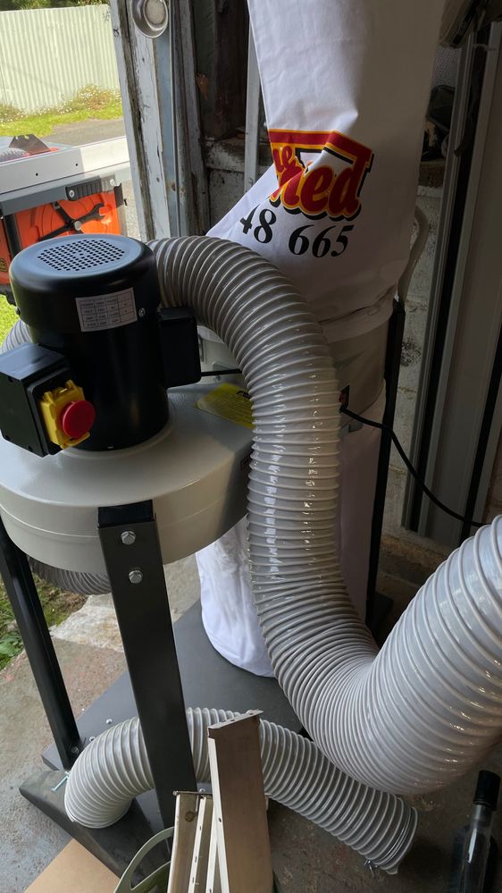

5/5I have just bought a dust collector which is low pressure and high volume. This makes dust removal so much better. But as you’re making box for your equipment, it’s going to work just as well with a shop vac.
What this box does is allow the dust to drop into the holes of the hole board and get sucked into the vac. Gravity is doing a lot of the work and thus there is very little dust blowing around.

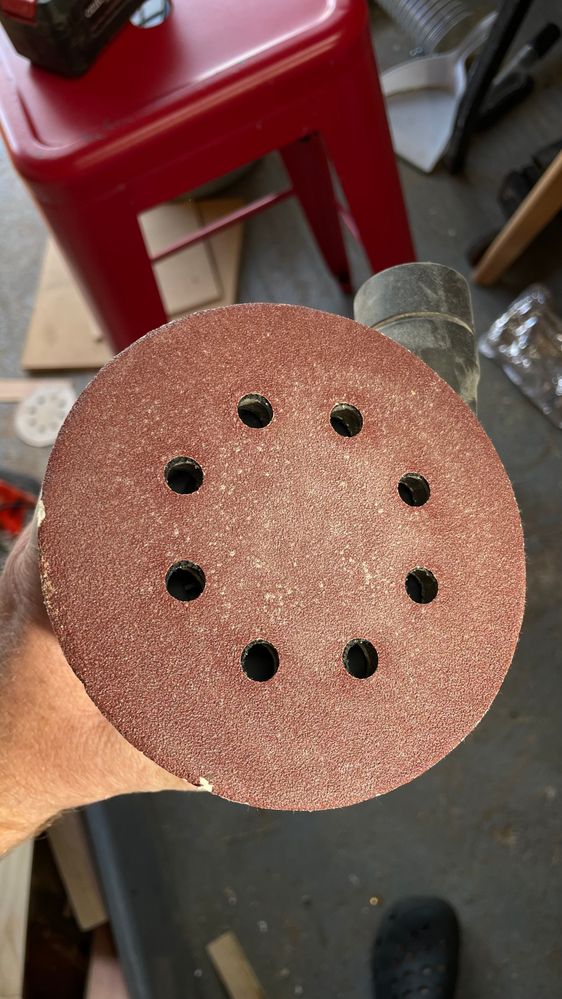

The amount of dust is reduced from the tool if you find a way to connect your tool. This saves wear and tear on your tool and also reduces wear on your sanding pads.
It works just as well using power sander as hand sander.

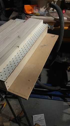

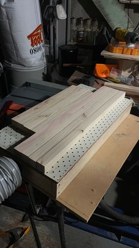

I built a new version this afternoon.
I made it longer and wider. I also made the base wider. This gives a nice place to clamp to the desk to stop everything moving around.
I used a jigsaw to cut the hole for the vacuum. This made for a tighter fit than the hole saw. I’m not sure if I’ll add the hole for the sander itself or if I’ll just use the shop vac as well. I probably will though.
