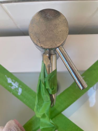

Hello, I need to remove this bathroom mixer tap to replace the cartridge (or the while tap if it’s beyond help, yet to be determined) as it leaks. I removed the grub screw but the top will not budge. Any ideas? Tap brand in Unique. Google doesn’t offer any help. I’m pretty sure the tap is as old as the house, 18 years give or take.  
Please ignore the painters tape. It’s to stop my children using the tap while I figure this out. Thank you.

Are you trying to remove just the handle or the whole thing? If the whole tap there will be a couple of threads through a plate under the sink ussually with a nut. You undo these and the tap will lift out. JDE

Hello, thank you for the info. At the moment just the handle. Any idea how it get it off?

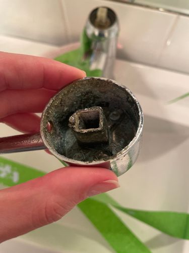

I ended up using a small flat head screwdriver to pop the handle off. So gross inside.

The chrome dome was finger tight so easily came off. I damaged the cartridge when removing the handle.

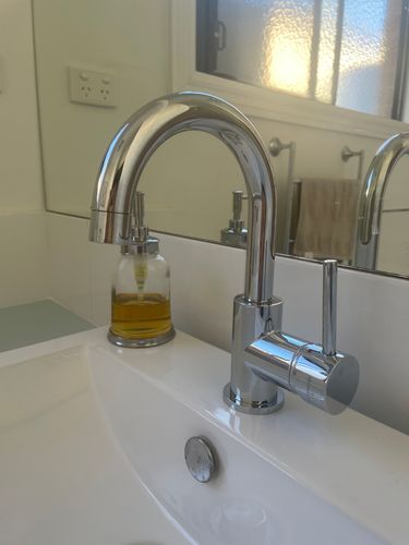

In the end the old tap was so nasty and gross, a new tap was needed. I removed the old tap and installed a brand new one.

Love your work, @apple16! Given the price of the new cartridge for an aged and worn tap, sometimes it's just not worth the effort. I think you made a smart decision, and the new tap looks wonderful.
Well done!
