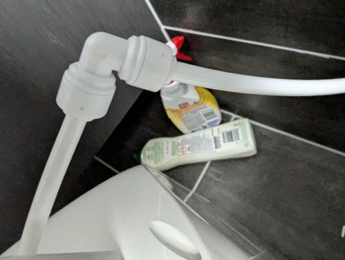

 hi community,
I'm trying to remove a bidet but this attachment is stuck. Have tried to pull out the hose with strength, tried "unscrewing".
Any guidance?

Hi @angben,
Looking at the attachment, it appears that the pieces would screw into each other. Anything with water flowing through it is susceptible to calcium and scale buildup, so it may have seized in place.
When you tried unscrewing them, did you feel any movement at all?
You might have more success using a mechanical aid such as some multigrips.
If unscrewing isn't the solution, the best thing we can do is track down the installation manual for the bidet and reverse the process.

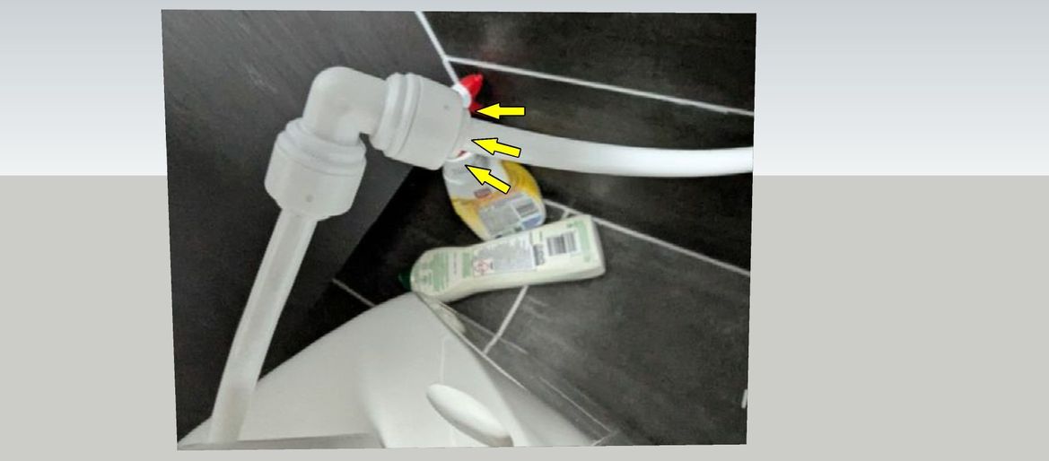

Hello @angben
I suspect that this is a push to fit fitting. I suggest pushing the white ring down that I have indicated with the yellow arrows while pulling the white hose in the opposite direction. The white ring must not lift up otherwise the hooking claws will continue to hold the pipe in place. You can surround the white ring with the tip of your fingers and hold tight.
