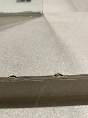

Hello, I stupidly dropped a glass in the bathroom which bounced onto into the shower and has chipped the porcelain tiled step into the shower in two spots (photos below).
Any tips on how I can rectify rather than replace.
Thank you
Hello @jwilliamson
Thanks for sharing your question about your chipped bathroom tile. I suggest using Selleys 50g Knead It Aqua Epoxy Putty, It's suitable for use on fibreglass, wood, ceramics, metal, concrete, glass, masonry and most plastics. Mix very well in your hand to make sure that the product activates properly. Push the putty into the damaged area and shape it carefully with your thumb. Do not over fill the spot so that you won't have to do a great deal of sanding.
Leave the putty to properly cure before you sand the surface to level. Please note that the putty will dry light grey and will not match the finish of your tile.
