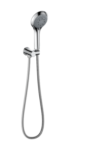

Hi there,
I’m desperately searching for the installation guide for the Mondella Chrome Resonance 5 Function Hand Shower WELS 3 Star 9L/min https://www.bunnings.com.au/mondella-chrome-resonance-5-function-hand-shower-wels-3-star-9l-min_p500...
I have misplaced the one that came with mine and I cannot for the life of me find any of the Mondella Installation Guides online anywhere.
Can anyone help me out please!?

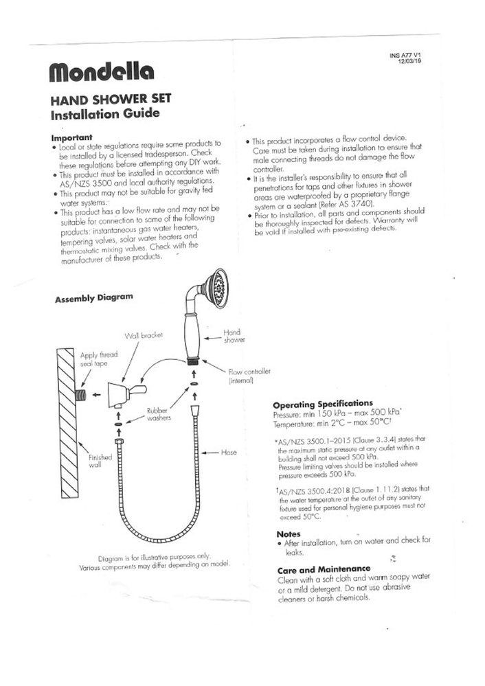

Hello @Melody185
My apologies for the late reply. Mondella has sent me a generic installation instruction set for your shower head which I've placed below. The instructions for installing the Mondella Chrome Resonance 5 Function Hand Shower WELS 3 Star 9L/min is similar to single wall mounted unit with their outlet integrated into the holder. I suggest giving it a try and if you run into anything you are unfamiliar with, please don't hesitate to post a picture and a question.
Thank you for your patience.
