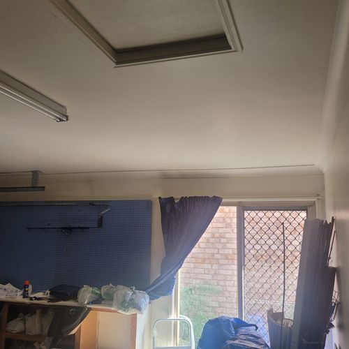

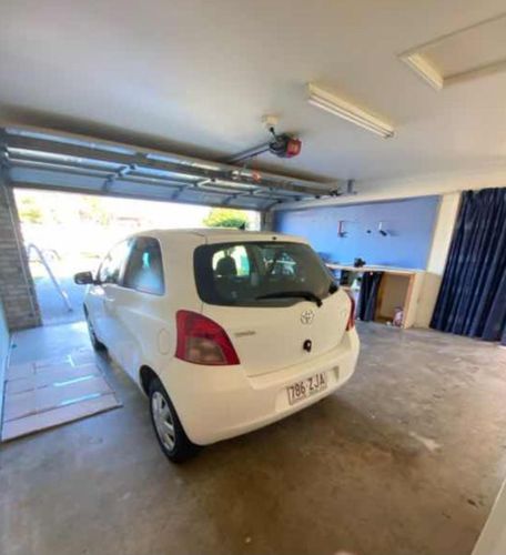

Can you upload some photos of the space? This would help our members better understand the space and what you are trying to achieve.
If there is already concrete in your garage, there may be no need for anything additional as long as it can be waterproofed to the required standard. They may be able to polish the existing concrete, which would save on material costs.

Good Evening @ivanptr
I am also thinking of the fall of the existing floor, Garage floors may have a slope towards the entrence (mine does but its older) that plus having a floor fall towards the waste holes is why bathrooms have the mud and tiles to help create that tint much needed angle for the water to flow away naturally.
Thinking of your garage floor and some pics could help with ideas. Does it slope at all? And where are your existing waste serices located compared to where you want the new bathroom. The last question is "Does your local council allow" garages to be converted into bathrooms? I know my council frowns on garages being repurpurused into rooms as it means the car spot thatw a sthere gets bumped and so on until its on the street. Its not illegal but not keen. It may be an idea to check.

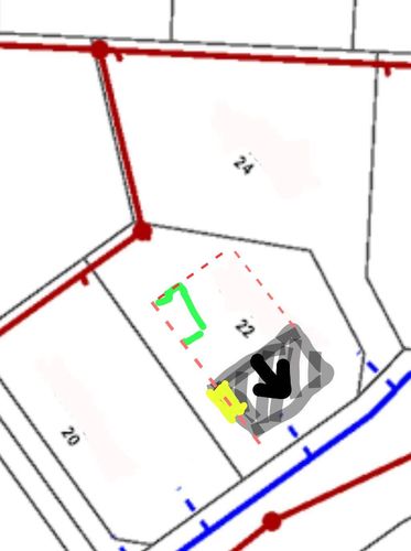

So the general idea is to handle the plumbing first, then apply a waterproofing liquid membrane on the existing concrete floor, pour new concrete to adjust the slope, and finally finish by polishing it ? Please let us know if we have misunderstood anything.
Regarding the pipe location:
Red line: Waste line
Blue line: Water supply
Black arrow: Fall direction (0.5°)
Yellow: Glass screen door
Green room: Current toilet and bathroom
We’re considering converting half or 1/3 of the garage to save costs. Limiting the floor area might make using tiles more feasible.
Yes we plan to consult with a builder, but we’d like to have a general idea 🤔 before discussing it with them. Would love to hear your advice 🌳

Hello @ivanptr
As you are aware there are many rules to be followed in regards to conversion. But the steps you've outlined are generally what needs to happen. Your builder will give you more details such as how thick the concrete should be, what type of waterproofing to use and the layout of the plumbing for the area. My best advice is to ask for a detailed quote for materials and work to be done.
Please keep in mind to make provisions for ventilation, its best to have an exhaust fan in the bathroom to pump out all the moisture in the room when showering.
