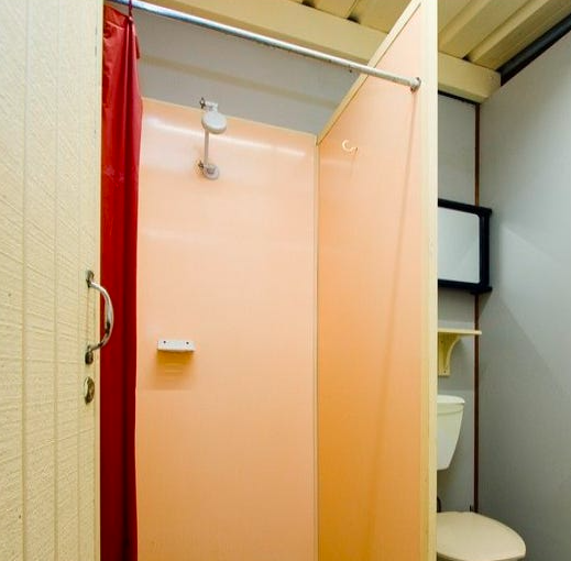

Hi.
I need to resurrect an old, old external bathroom (built in around the 1970s) to use while another extension and bathroom is added to the main house. I have had to do repairs which included taking off the pink wall panels in the shower area. I have scrapped the old construction adhesive off both surfaces (the back of the pink panels and off the grey walls underneath).
I need to re-glue these pink panels back onto the grey walls which are some sort of  layered thin surfaced melamine type material with chipboard inside!!! This bathroom is an example of how to NOT build a bathroom! I am not concerned with waterproofing as it will be demolished asap after the new bathroom is finished. I also need to  attached a sheet of Suntuf Palopaque that I bought at Bunnings to an area near the vanity onto these grey walls.
Can you please tell me which is the best construction adhesive to use to attach these panels. Do I need one made for wet areas with steam from the shower etc.? I would like it to last for as long as I need it to without the panels falling off!

Hi @Bel789
Just to be on the safe side, I suggest using Selleys 325g Liquid Nails Rapid Cure Strong Waterproof Adhesive. It's designed to withstand a wide range of temperatures and will work on different kinds of materials.

Re: Bathroom Wall Panels
Thanks Eric.
I will be very happy if the panels stay on the walls. I don't want them to fall off and hit my head as I shower with my eyes closed dreaming of my new bathroom!
