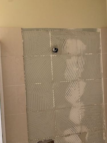

Re: Tiling over tile: do you need to waterproof?
Thank you for all your advice. Started my journey will remove everything from the bathroom before getting all materials and equipment from Bunnings. My only question from the pictures attached I was able to remove the tiles there is cement is it better to sand it down or grind it and with what equipment. Or should I change the wetherboard or is it gyprock
completely. Thanks in advance
If it wasn't for the large hole, then you'd likely be able to apply your tile glue over the existing one without grinding it back if it was in good condition @Andrear. If you do any more damage to the wallboard or compromise the waterproofing, then you'll need to replace the wall sheet. Remember that if the waterproofing is damaged, you'll need to restore it to the shower recess and the whole bathroom floor. It's one continuous layer over the whole bathroom and you can't repair just the shower recesses section. Are you removing the floor tiles as well? You might like to start your own discussion and provide some details on your project. That way we can give you specific advice.
Hi mitchell
the hole was done when the plumber fixed the leak. My idea was to remove the tile for the entire bathroom fix the current hole or maybe replace the full piece in that side of the wall with villaboard. Put water proofing  on the entire new piece. But I I can see the other walls might need to put water proofing as you can see from the pics there was no water proofing done. I am also doing the floor will remove existing tiles as well.
Ok @Andrear, I just wanted to ensure you're working on the whole bathroom. Waterproofing is under the tile glue, so you won't necessarily see it, but re-waterproofing sounds like a good idea. In that case, you could remove the glue, but it's a very dusty process. It might be worth speaking with a waterproofer to discuss what type of surface they'll need you to provide.
