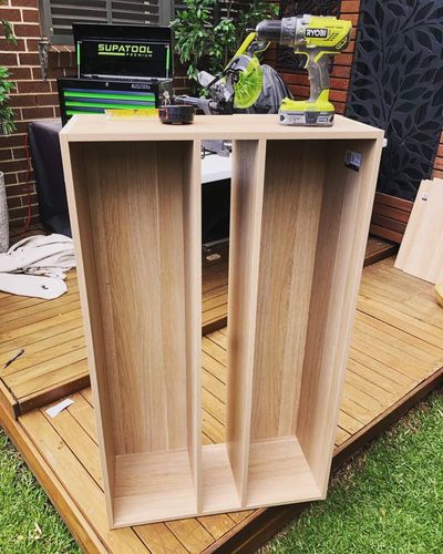

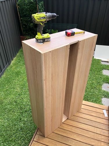

I'm sure @diy_hausdesigns can provide some more details, but it looks like the construction is fairly straightforward. I'll include some images below of how it appears to have gone together. You'll need four lengths cut to the same length as the width of the gap. These will be the top and bottom, plus the two rear panels. Cut two lengths 32mm less than the previous boards, as these will be the shelves that fit internally. You'll cut two boards for the side panels 32mm less than the required overall height of which you would like to build the unit. All panels then need to be cut to suit the depth at which you'd like the wall unit to be.
The panels can be screwed together with Zenith 10G x 50mm Zinc Plated Countersunk Head Wood Screws. You'll find the P&N 4 Piece Quickbit Pilot Drill / Countersink Bit Set really helpful at pre-drilling and countersinking your holes simultaneously.

@MitchellMc has 'nailed it' 100%. It is fairly simple to put together. The rear panels provide good bracing making it quite sturdy and easy to fix to the studs.
