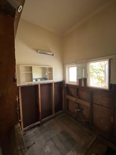

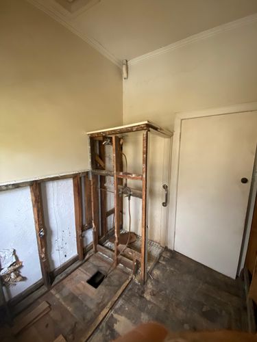

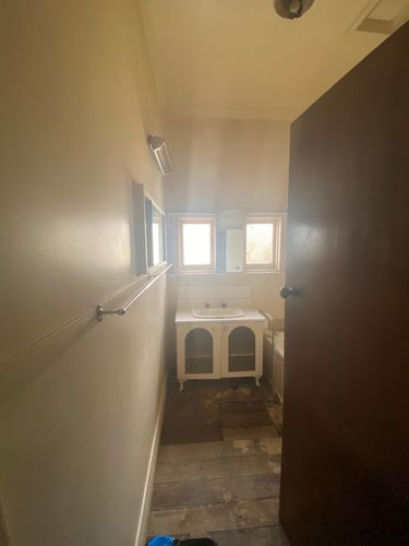

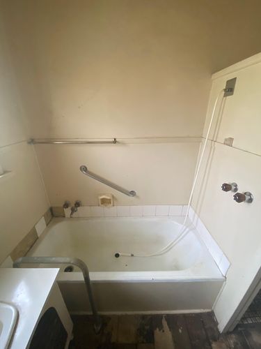

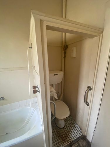

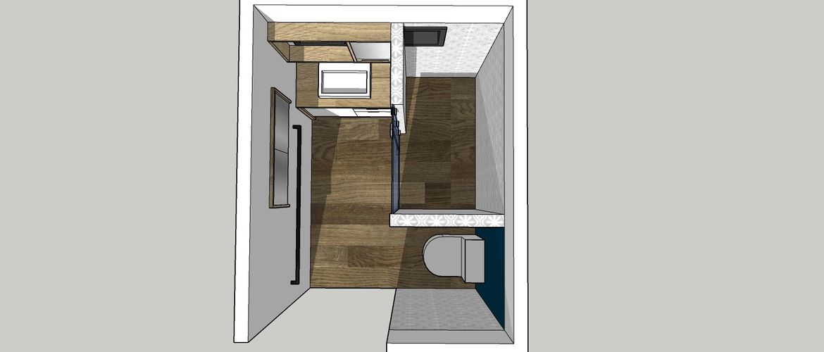

we are renovating our very old and dated bathroom. The photos are before and after having all the asbestos removed.

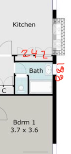

Any good ideas on configuration to make the best use of the space?
we were thinking of keeping it pretty much the same as it was but a walk in shower rather than a bath. Or even having a shower/bath across the windows instead.
I’m very much a reno newbie so any advice on what to do first, waterproofing, use of space, tiling etc is welcome!
thanks in advance

The first thing to do is plan out the space and decide exactly where your elements will be placed. You'll then be able to move on to the next step of laying tile underlay and waterproofing the appropriate areas. You should find these step-by-step guides useful:
I've spent some time having a look at a few potential layouts. My personal favourite is the last, including the partition wall. This wall could be substituted for a glass divider. Appropriate waterproofing of the window sills would need to be completed to ensure no water damage occurs.

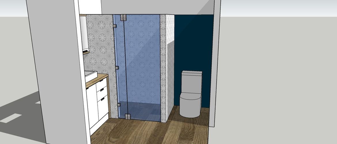

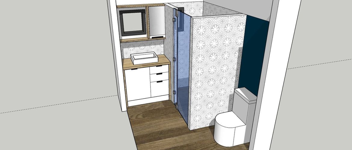

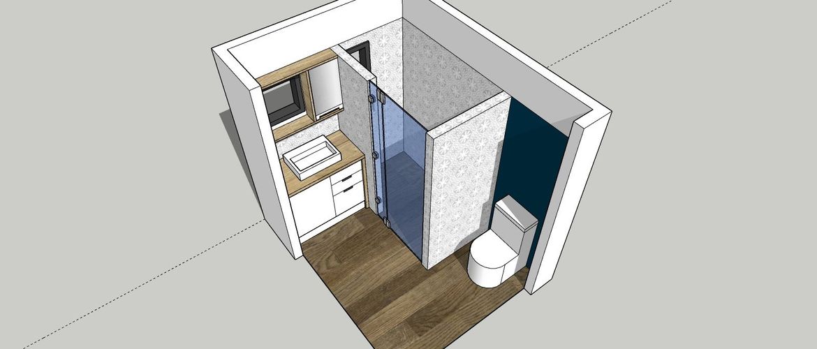

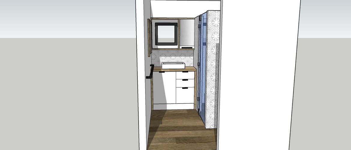

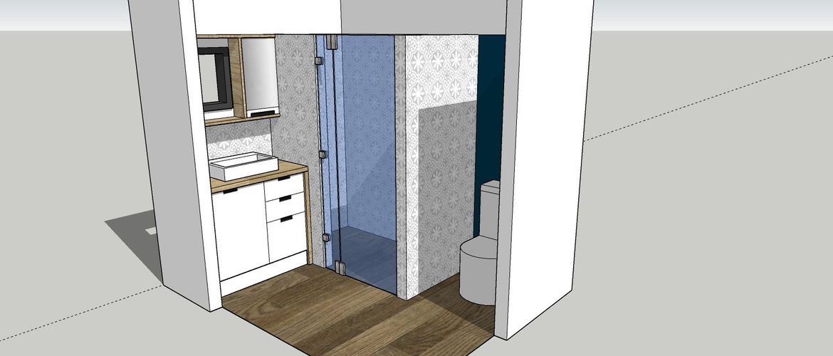

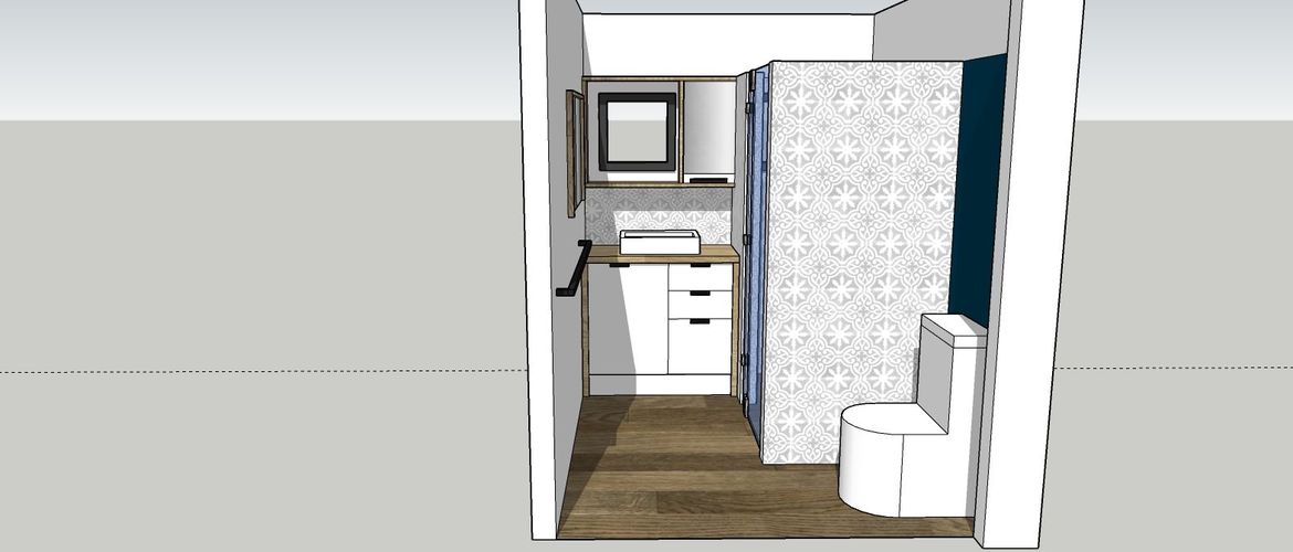

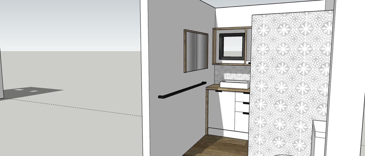

Hello @georgiaks
Welcome to Bunnings Workshop. Below are my suggestions for your bathroom renovation. I've pretty much put everything where they were so that you will not have to spend too much on plumbing. I just added some modern touches and a massive shower for you. Hope you enjoy the drawings.
Cheers,
Red
