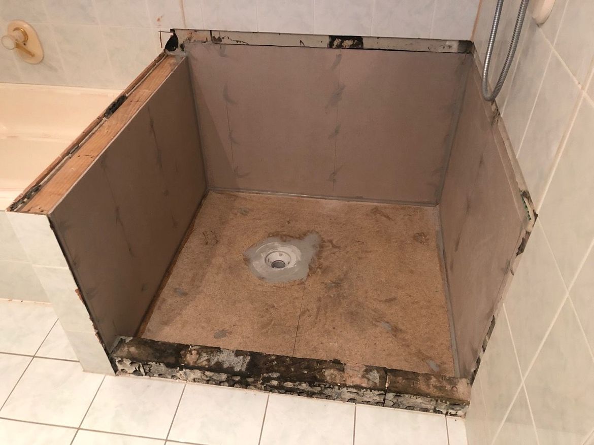

There was a waterleak in the upstairs shower... The 2 layers of tiles have been taken up and the water damage traced and taken out.
The repaired section of the floor is slightly lower than the original floor so I want to know how to prepare the floor (so it is ready) to add a custom built base (yet to be ordered)
I am aware that waterproofing is essential and am adding timber to all the sides to help form "the tub"
Next after the timber sides will be cement sheet (which will be waterproofed)
Is it important to get the floor completely level or will the cement slurry provide the necessary base (after waterproofing?

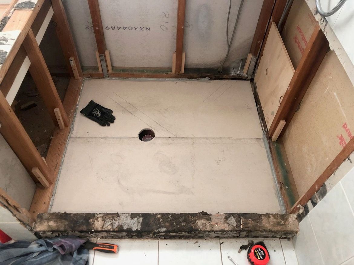

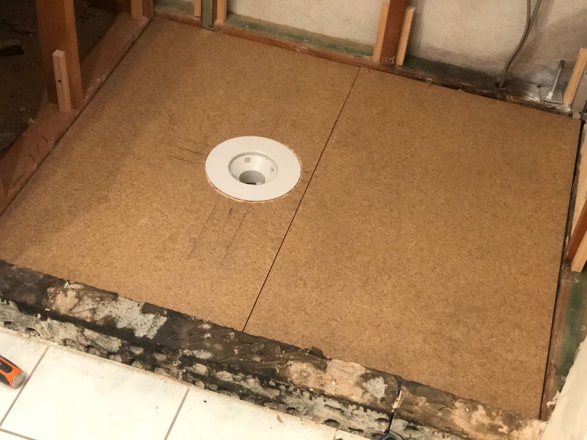

This photo is of the  19 mm Cement sheet which was added to raise the floor as well as prevent any opportunity for the yellow tongue, which will go on top, to bend or move.
Yellow tongue with the countersunk flange installed. This is later screwed down to the floor joists.

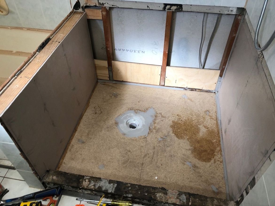

Adding cement sheets to the walls.
Cement sheets added to the walls and joins filled in with Crommelin Silicon WP Plus.

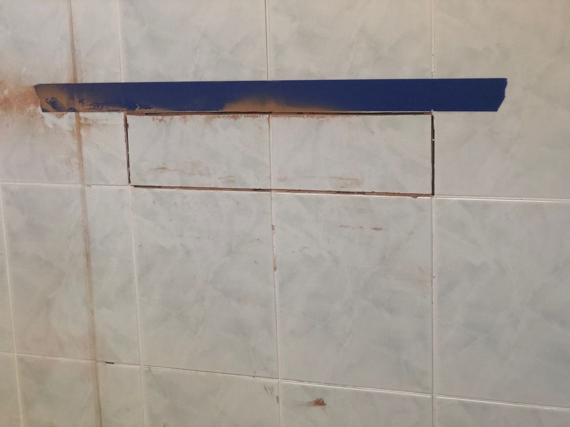

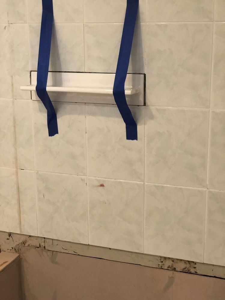

Carefully cut the tiles to add a shelf.

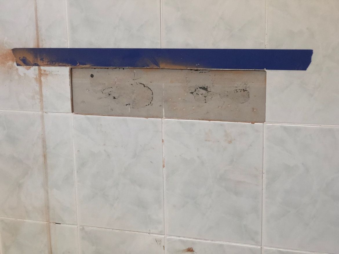

Tile pieces removed and ready to fit the Shower Shelf.
Glued the shelf in.
Taped up all the joints and applied Shelleys Flexiseal to the joints as well as using the remainder of the Flexiseal  to waterproof the yellow tongue.

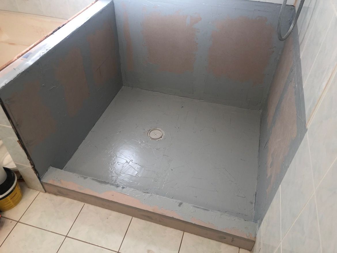

Waterproofing multiple times to make sure it wasn’t going to leak and now ready for tilingWaterproofing multiple times to make sure it wasn’t going to leak and now ready for tiling

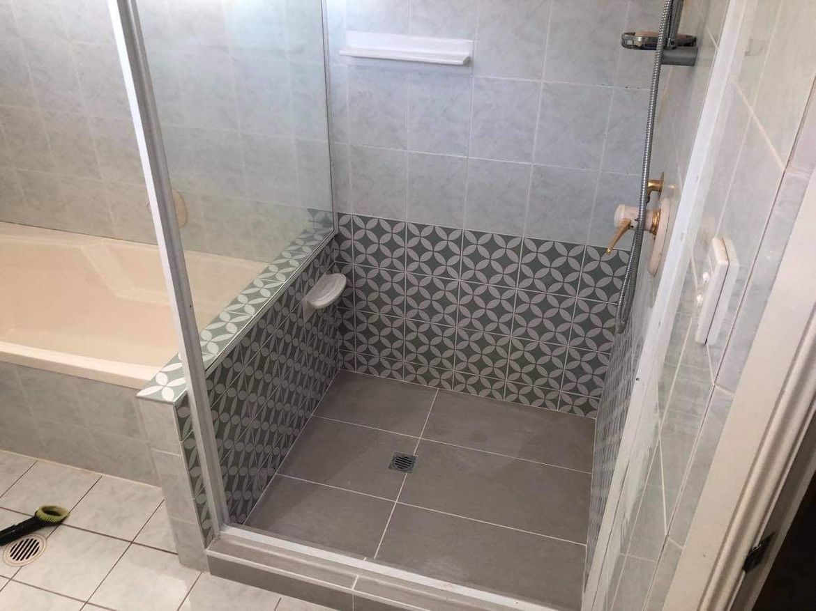

Completed the shower and only the doors to hang
Tiling done. I did not use a screed to get the fall. I used the tile glue to get a fall to the drainTiling done. I did not use a screed to get the fall. I used the tile glue to get a fall to the drain
