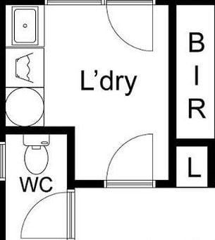

We're planning a renovation and would like to convert our existing laundry into a combined bathroom and laundry space. This change is necessary as we're incorporating the current bathroom area into the kitchen to create more space there.
We're currently having trouble figuring out the best layout to make everything fit efficiently in the available space.
I've attached the existing layout along with CAD drawings that include measurements, as well as a proposed layout. Please note, the proposed layout is just a rough reference and not final.
It would be greatly appreciated if someone could assist us in developing a practical layout for this room.
All measurements in the CAD drawings are in feet.
Thanks in advance for your help!

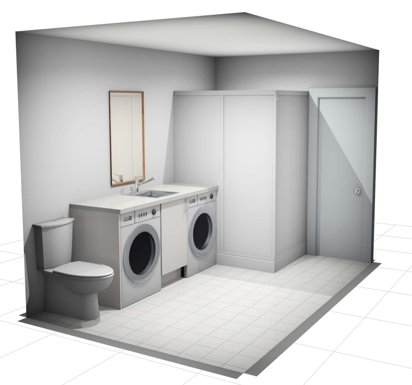

I've created a rendering below that could keep the flow working quite well.
Hi Mitchell,
Thank you — I really appreciate your help with the layout!
I was wondering if it might be possible to add some storage in the laundry area?
Also, I noticed the toilet is positioned directly in front of the door. I’ve heard it’s generally not ideal for a toilet to face the door — is there any flexibility with the layout?
I was also thinking, would it be possible to do a Euro laundry setup, with the sink and vanity along the same wall, and the toilet next to them? Do you think that could work?
Thanks!
Like I mentioned, cost-wise it best to have the toilet as close to the existing pipework as possible @diva9. However, if you are on stumps and not a concrete slab relocating the pipework is an option. You could shift the cabinetry and washer, and dryer down to the corner and have the toilet between it and the shower.
Storage is entirely possible. You could certainly add it above the lower cabinets from the shower to the wall.
Regarding including a tub, it doesn't look like you'd have enough space for that, but you've cut the measurements off on the plan, so I can't tell the actual length of the wall. You could stack the washer and drier in the corner, and then you would have enough room for a laundry sink, vanity, and toilet.
