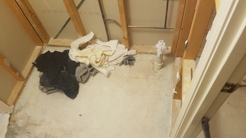

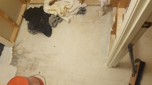

Is anyone able to advise if I am doing something wrong here. Bought two floor wastes and they both seem to be too high. Is there something I need to do?
Seems higher even after adding two tiles. I can't go higher because the floor has to match the adjacent floor. Im thinking maybe the underlay should have been thinner. However, dont think it comes in any size other than 6mm.
Hi @BryceBrad,
Your waste pipe height needs to be set to accommodate your drain grate thickness. The section that retains the grate on that floor waste is too thick and would require the connection to the waste pipe to be much lower down. You'll note that grates like Kinetic 100mm Chrome Brass Square Floor Grate are much thinner and more in the realm of where you must be. This might be a case of the plumber presuming you are using an older style floor waste and setting the height to suit.
