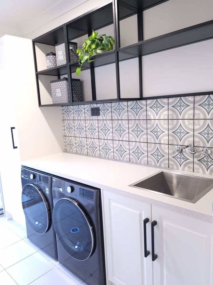

Kaboodle cabinets and top have been use to make the perfect modern and functional laundry. What was once a small and uninspiring room, it is now a pleasure to work in.
Materials
Tools
600 wide pantry unit
900 wide base cabinet
Two 600mm Kaboodle open shelf units
One 900mm Kaboodle open shelf ( cut down to fit)
Almond Brittle bench top
Antique White - heritage doors
Antique White end panels
500mm square stainless steel sink
Gabana Rubeli decor tiles
Dunlop Grout and silicon ( Midnight Black)
Spirit level
12V circular saw
Electric screw driver / drill
Jig saw to cut in sink
45 mm ceramic hole saw for plumbing to come through tiles
Tile cutter / Angle grinder
Steps
Step 1
1/1Clear out the room .
Assemble both Kaboodle cabinets.
Install 900mm wide cabinet, and bring plumbing through floor and back panels.
Set the gap for Washing/ Dryer machines between cabinets.
Install pantry unit. Make sure everything square and level.
Install End panels.
Cut the Top to length and Install.
Cut out the hole for the Sink and join up the plumbing.
Swing doors and add handles.
Glue the tiles to back splash wall .
Install overhead shelves.( Note: I had to cut the 900mm wide shelf down to 860mm to suit my gap)
Grout the tiles.
Job Complete.

Welcome to the Bunnings Workshop community @ChrisandTracey. It's terrific to have you join us, and many thanks for sharing your wonderful project.
Congratulations on transforming your laundry into a sleek and functional space! The choice of tiles for the splashback adds a such a great touch, and the layout of the cabinetry is on point. I really love the whole look you've achieved here and you must be just thrilled with the results.
It's inspiring to see how your efforts have turned what was once a small and uninspiring room into a pleasure to work in—well done!

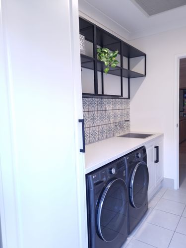

For those that wanted to see what the room looked like before the renovation, as you can see it was a depressing space. The refit has made the area lighter and somehow more spacious. From cabinet making, fitting out, plumbing. Tiling and painting it took us about 1 full day and two afternoons to complete.

Ooooooh, you had me at *those* tiles and the colour scheme...but I'm biased because I chose a blue and white colour scheme for my utility room reno, too! Loving the clean lines and especially your sink.
Your 'before' laundry shots aren't too bad; mine could be used as setting for a film that's shot in a filthy dungeon... But, like you, now, as soon as anyone in the family puts an item in the dirty laundry basket, I'm practically skipping to my utility room to wash it!
Congratulations and enjoy the fruits of your hard labour!
