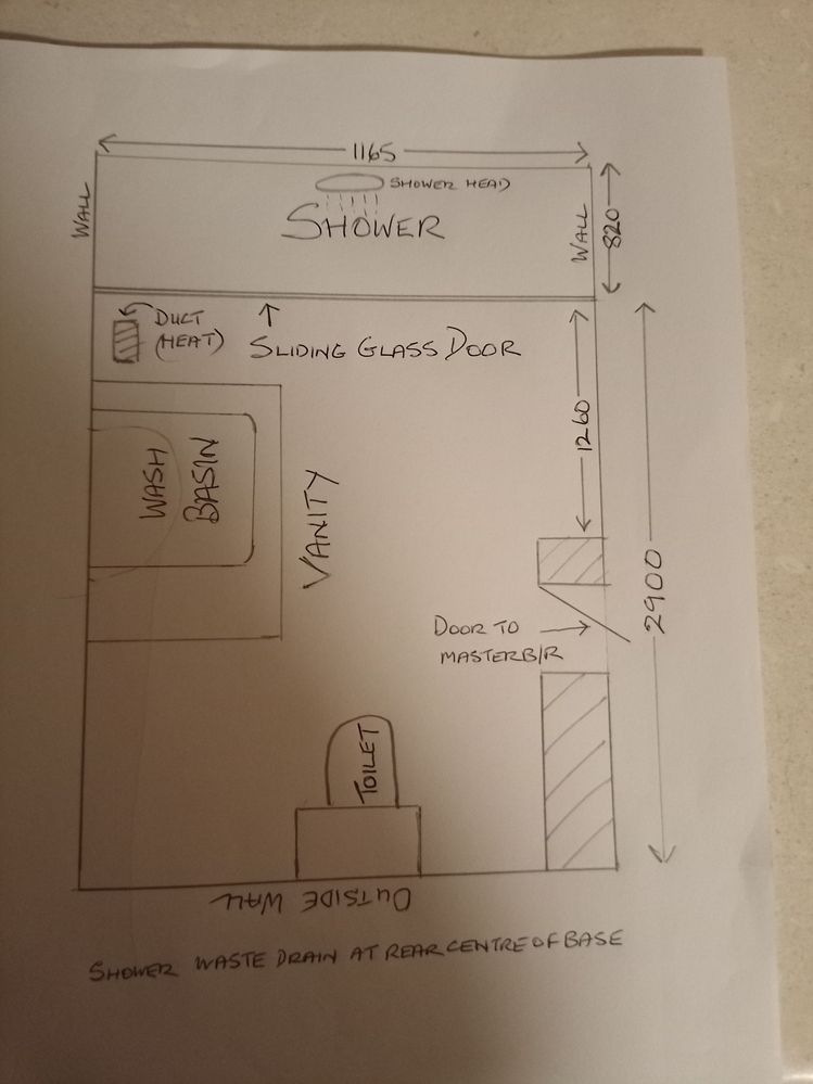

Can you please tell me the dimensions of your entire bathroom and the proposed location of the shower? Perhaps I can suggest a configuration for your shower where you won't have to spend so much for the door.

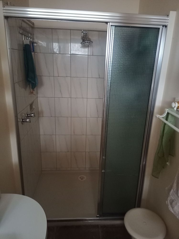

Attaching 2 photos of ensuite to renovate.
Shower (wall to wall) 1165 wide by 1840 high
Shower base 1150 W x 820 Deep
Need sliding door type front screen only (in 2 or 3 sections) - no returns - all enclosed by walls
Ensuite Length 2900 excl Shower x 1165 wide
At 1260 mm back from shower, width reduces by 160 from 1165 to app 1005, due door to master bedroom.
Location of shower will remain where is, but completely replaced with new sliding door and base, new tiling.

Eric I attached 2 photos with my last reply - not sure if you got them ? maybe issue with upload??

Eric - attached photos again with diagram & measurements
