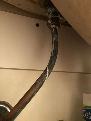

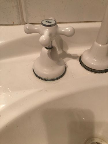

I am wanting to replace old bathroom basin taps joining to copper pipes which is leaking into the cabinet below.   I am wanting to get some standard basin tap set but will also need new flexi tubing to replace the copper pipes and wanted to add isolation valves.   Am needing advice as to how to get the parts needed so it all fits together or are there any basin tap sets with everything i need included? Thanks.

Here's our range of basin sets to choose from, our flexible water connectors, and the Chrome Mini Cistern Stop you require. You'll also need some Kinetic 12mm x 10m White Standard Thread Seal. There are no kits that include all these parts.
