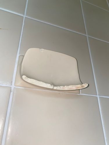

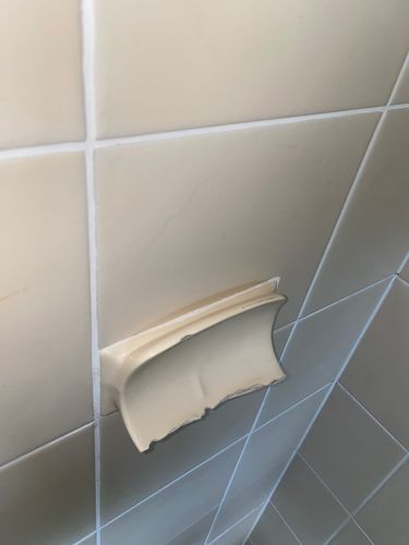

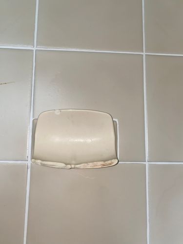

I’ve elbowed my ceramic dish soap holder in the shower and looking to remove the existing holder and install a new one. What are some recommended products to purchase for this repair? I’m looking at purchasing the Ryobi 18V ONE+ Multi Tool R18MT3-0 to remove the grout. Any recommendations for a new ceramic dish soap holder at Bunnings?

The Ryobi Multi Tool is not a bad idea and will certainly assist, but what you really need is a cold chisel and a mini sledgehammer. Whilst wearing appropriate PPE, including safety glasses, gloves, facemask, long-sleeved shirt and pants and enclosed footwear, break the rest of the soap holder into pieces and chip the remaining chunk from the wall with the cold chisel. The Multi-Tool will work great for the grout, but the tile glue behind the soap holder is doing the lion's share of holding it in position.
You'll then be able to install the new soap holder using tile glue and grout the edges.
