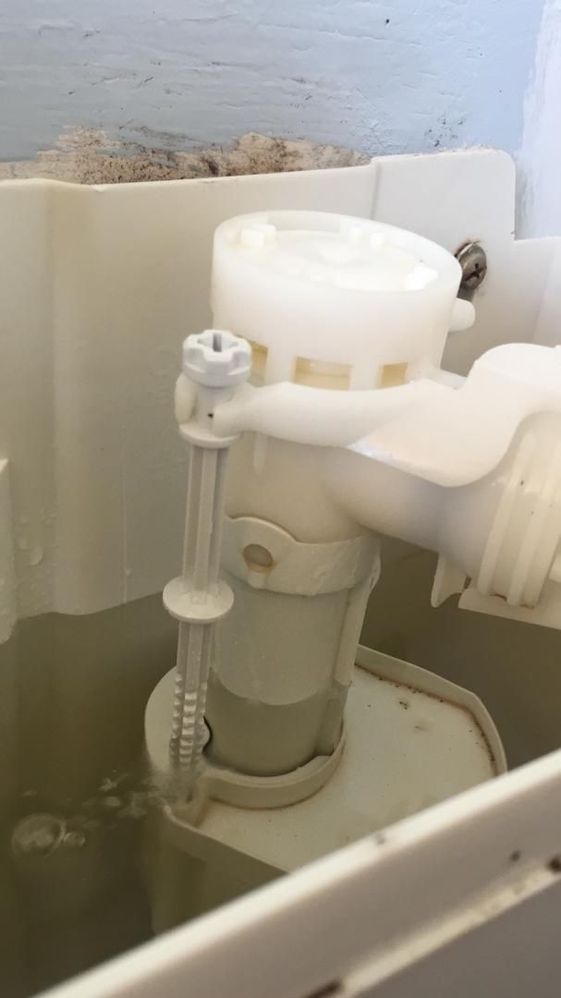

A friend managed to remove the cistern cover and we can see where the leak is.
Any suggestions whether it can be a DIY ?
Thanks.
The point of leak

The easiest option to fix this issue is to replace that inlet valve with a universal Fluidmaster Bottom Entry Toilet Inlet Valve. Where that valve is spraying from it appears there might be a hole or crack in it. It doesn't look like it is leaking from a washer that you can replace.
Here are the instructions on how to install the new valve.
