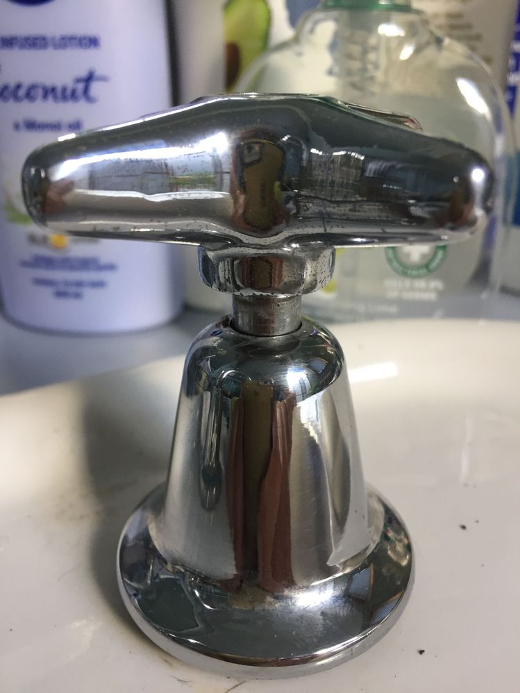

Hi.
This is the tap and the tool to undo the handle. My problem i the tool always slips out of the socket hole when I apply pressure. Also, which way do I apply pressure to unscrew it -clockwise or anticlockwise ?

Once the tool is positioned and as you look down - turning should be clockwise - to undo it.
I personally have had limited success with the tool due to significant calcification of tap components and it's rather fragile design.
I had the same taps as the guy in the video - I think he was very lucky. I removed (eventually) mine and replaced them with taps that have the locking srcew at the top and visible.
With the water supply turned off and the tap turned completely on - can you undo the flange and expose enough space for a shifter or an open ended spanner to completely remove the tap? That way you may have better luck with that tool.
Let us know how you get on.

It's great that you've received excellent advice from @Noyade. You're going in the right direction as you have the proper tool to disassemble it. Sometime calcium deposits lock the nut in place, and it takes several tries before the hidden fixing comes loose.
I can only recommend to keep going and keep trying until you get a good hold of the fixing and turn slowly. One other technique you can try is to slot the tool in place and keep your tool hand firm, then turn the handle instead.
