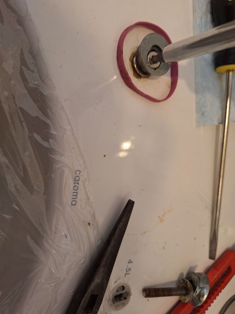

20251108_162317.jpgHi @MitchellMc
I have gotten the seat itself off the toilet and the screw is jammed into the hidden fixture underneath.  I am pretty sure it is corroded.  If I cut the top of the screw off, how do I get the base out unscathed to attach the new seat?

Hi @JBlondebrick,
Before you get to the point of cutting off the screw, try using a tool like those pliers or a chisel to lever the screw upwards while rotating it with the screwdriver. Sometimes all you need is a bit of pressure on the threads to get them moving and the upward force can help to force some movement. A spray of WD-40 and a couple of minutes for it to soak into the thread could also help.
If you still can't get the screws out, you can always cut them off and replace them with one of these FIX-A-LOO Toilet Seat Blind Fixing Kits.
If there are caps low down on the side of your toilet, you may also be able to remove these to fish out the existing fixing and then just replace the bolt.
