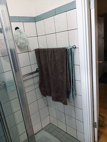

I'm hoping someone can please help me or give some advice.Trying to remove this metal fixture on wall which has 4 sides and was used to support the shower screen that I've now taken out. There are no tiles behind it as bathroom was tiled around this fixture.Fixture is hollow and looks like up top inside is a hex screw holding it to wall which will not budge ! (Not sure if fixture has been glued to wall) .Would like to remove this without damaging tiles around it as not re doing tiles at this stage.
Thankyou Nikki

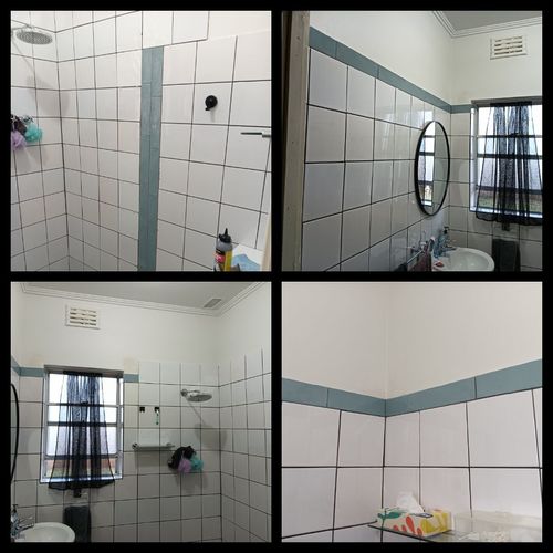

Used whatever I could to loosen the post by scraping along sides to get the silicon or whatever was to unstuck.I could then lift top part up to get to bolt and used hacksaw for part of it then went & bought a reciprocating saw that cut through rest.Bottom part would not budge tried every tool to get off wall just to get to bolts & finally managed to get a angle grinder behind it to the blots.Both steel poles had a bracket on inside holding them together with rivets which I drilled out firstly.Its taken 2 whole days to get it done.Have fixed up broken tiles & bought some feature type tiles to cover the wall.There was no glue on the wall or backs of post.So ATM this is what it looks like now.
Thanks for everyone's help.Nikki
