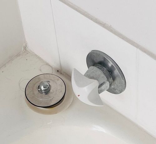

Can anyone please help me identify these shrouded taps, and/or tell me how to get the handles off ? I've had a look on YouTube, and everywhere else, but I can't find them. There's no button to hide a locking screw, no  grub screw through to the spindle, and no threaded lock-ring under the shroud that I can see. If they are simply push-on, pull-off, they are on very, very tight, and I am worried I might break them if I try to force them. Additional photos below for ID. Any assistance greatly appreciated. Many thanks. Steve

It looks like a traditional skirt-fixed handle. I suggest giving this method a try. Hold the top plastic handle steady with one hand. Place your other hand on the silver skirt under the plastic handle. Keeping the plastic top steady, turn the silver skirt anti-clockwise. If the skirt moves and makes it tighter go in the other direction.

Eric ! ... It worked !! You are a lifesaver. Thank you very much for your prompt reply. Very much appreciated.  👍

Thank you Eric for your invaluable advice. I have identical kitchen tap handles installed (circa 1988) to hassall147‘s tap handles. Your instructions worked immediately.
