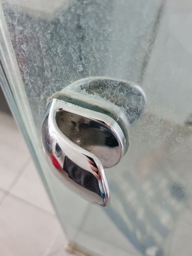

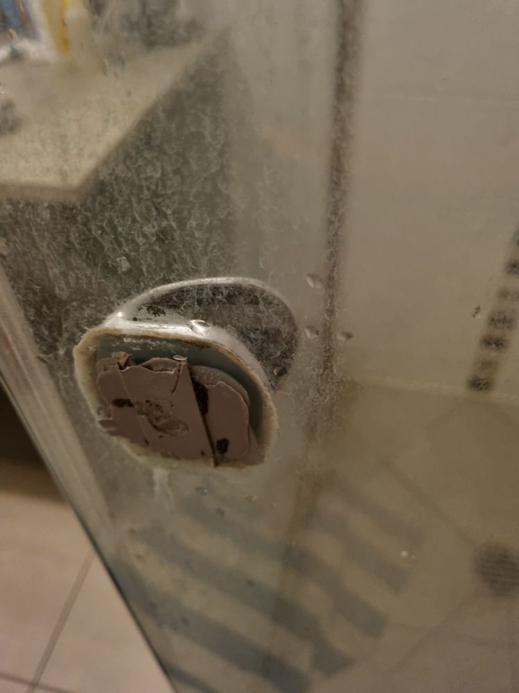

How to reattach shower screen's handle?
hi, I would like to seek the best method and product to reattach this glass door's metal handle. I read something like epoxy but I wasn't too sure.  Thanks.20240206_221825_resized.jpg 20240206_221831_resized (1).jpg 20240206_222705_resized.jpg

Hi @DonaldT
Some times I would  say  silicon but in your case as it is a handle i would use araldite epoxy glue. 5 minute or  normal  should  do.  Have  strong tape  ready to hold the handle firmly  in place until the glue sets, in say 24 hours for more full strength.
Re: Reattached shower screen's handle
Hello @DonaldT
It's great that you've received excellent advice from @Jewelleryrescue. I would also like to recommend having a look at Selleys® 10g Power Grip™Super Strong All Purpose Glue Adhesive. It is a superior all-purpose glue, with high durability. It sticks virtually anything, is shockproof, dishwasher safe, water and weatherproof, drip-free, heat resistant from -15°C to +120°C, paintable and solvent free.
It's best to hold the handle in place with masking tape until the glue cures. Once the glue is dry and secure you can take the masking tape off.
Please be aware that you are working with tempered glass and when extreme pressure is applied to it there is the possibility that it could shatter and cause injury. If you are having a difficult time removing the old adhesive, I suggest engaging the services of a professional glazier to remove it for you.

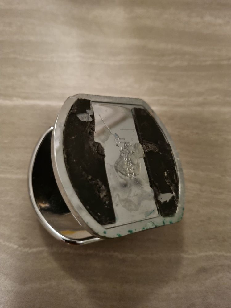

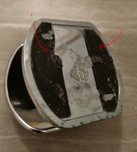

Another question.
What do you think of the 2 strips of black foam stuck on the handle? Shall I remove them as well before applying the epoxy & glue?
Thanks.
Hi @DonaldT,
The foam can likely be removed, but whether the adhesive will stick better to the foam or the chrome plating is debatable. Given that the glue might dissolve the foam, I'd remove it.

all fixed. got rid of the foam and used epoxy glue.
Start hardening around 3 minutes and then masking tape on. Fully cured after 24 hours.
So far so good. Thanks all for the advice. 
