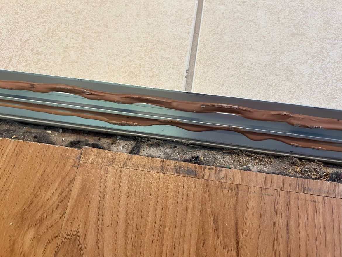

This aluminium strip that is bridging 2 sections came off. I want to know what kind of brown glue it is using. Could anyone help plz? Thanks
Welcome to the Bunnings Workshop community @fan8956. It's wonderful to have you join us, and many thanks for your question about glue types.
This look to be construction adhesive similar to Liquid Nails. It appears that not enough was used to make adequate contact with the subfloor. I'd suggest cleaning the exposed subfloor, removing any debris, laying a couple of nice thick beads of construction adhesive and repositioning the cover trim.
You want the beads of construction adhesive to be compressed down by the trim, which will adhere it to the subfloor.
