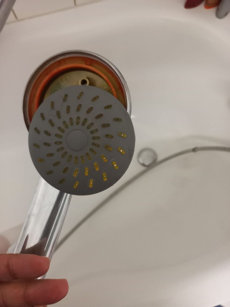

In order to clean, I accidentally took out the cover (that having small holes) from head of the hand shower . Now, I am unable to put back. If I assemble and start the show , by water pressure Its coming out again.
Please help me put the cover back so that it can stay tight witheheld the pressue.

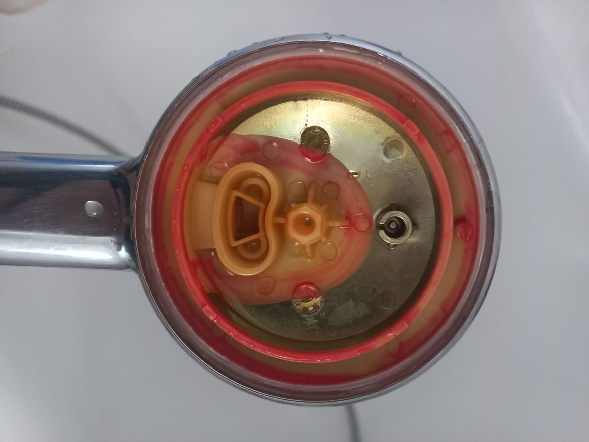

Hello @kousikb
I've placed an image below where I've highlighted the hexagon shape on your shower handle. I suspect the shower cover was originally glued to this piece which allows you to rotate the cover. I propose using Gorilla 3g Super Glue to stick the cover back to the shower hand piece. Please make sure to give the glue enough time to cure before using the shower head.
However, if the glue fails, I can only suggest replacing it with a new shower head such as the Flexispray Chrome 3 Function Federation Shower Handset WELS 3 Star 9L/min or similar.
