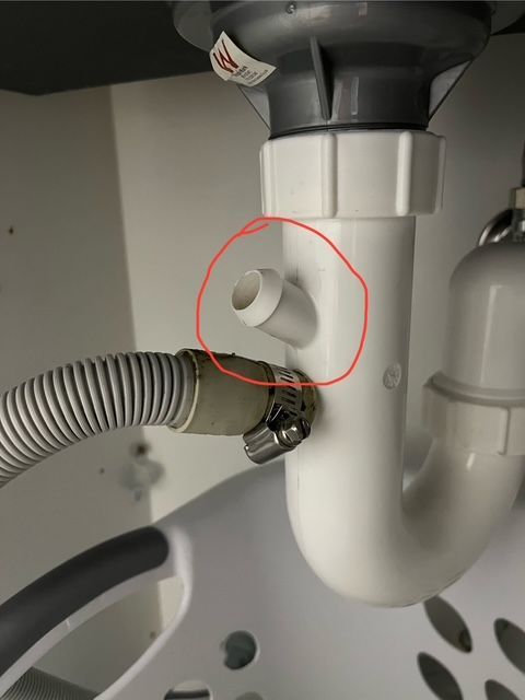

Hello, I have recently installed my washing machine in a new property. The drain pipe has two barbs. I have attached the washing machine hose to one barb with a hose clamp and it is working well. How do I plug the second barb (above the connected barb) so that the bubbles don't overflow out? Is there a product for this purpose?
Second barb is circled. How to plug it?

This Deks PVC Trap Dishwasher Outlet Cap will resolve your issue. It simply pushes onto the un-used barb, and the clamp holds it in position.
