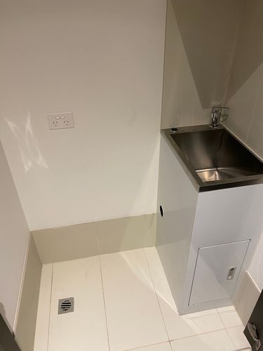

 We’ve just moved to a new apartment and got a Bosch Classixx Washing Machine. The set up in the apartment is unlike I’ve seen before and I could use your help. I’ve attached pictures of the space. Any help is really appreciated!

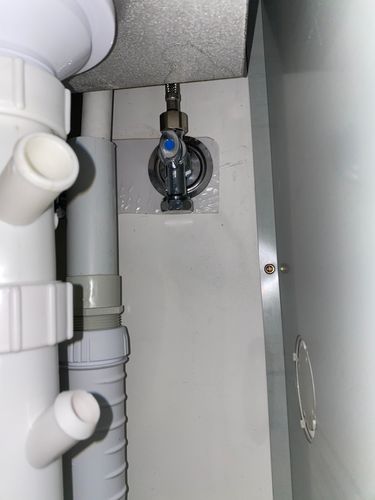

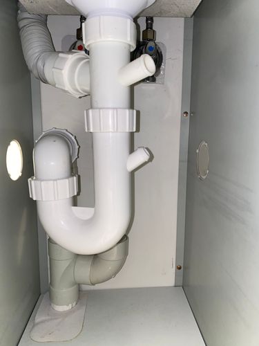

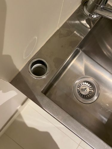

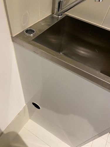

I suggest having a look at this guide - How to connect a dishwasher (the connecting techniques are very similar). The laundry tub you currently have has been plumbed to accept both traditional top exit and trap waste exit connection. The hot and cold taps can be accessed through the side of the tub and the waste pipe or exit pipe can be placed at the top of the laundry tub or linked to the nipple of the waste trap.
Please double check that it has been drilled through before connecting it to the trap. If it has not been drilled through, it will need to be drilled before you connect the exit pipe of the washing machine. Please make sure to use a hose clamp to prevent the exit pipe from coming off.
