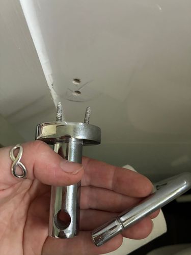

Wondering how I replace this toilet paper holder that’s fallen out of the wall and come apart?

Are you looking to put your toilet roll holder back in place or replace it altogether? Either way, you have two options.
The first is to move the toilet roll holder over, fill the existing holes, then use plaster WallMates to reattach the toilet roll holder.
Alternatively, you can get rid of the screws that were provided and use Ramset 16mm Hollow Wall Anchors with the existing holes.
Check out How to hang just about anything for some further guidance on anchoring to different surfaces.
