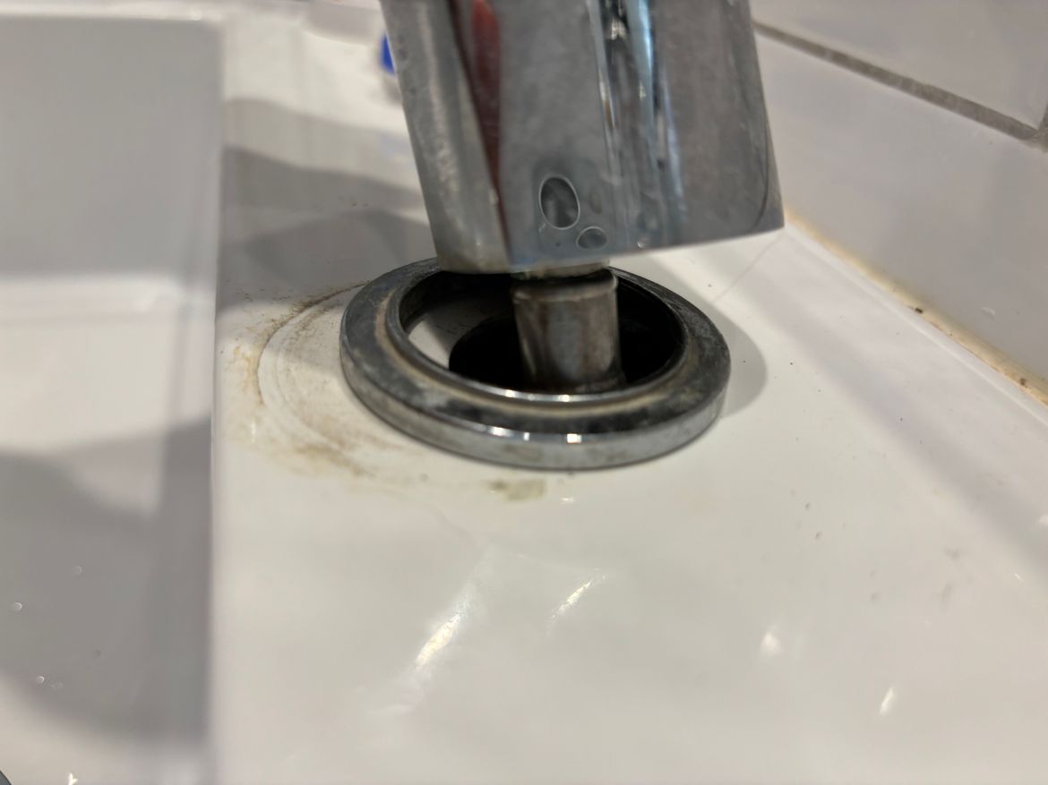

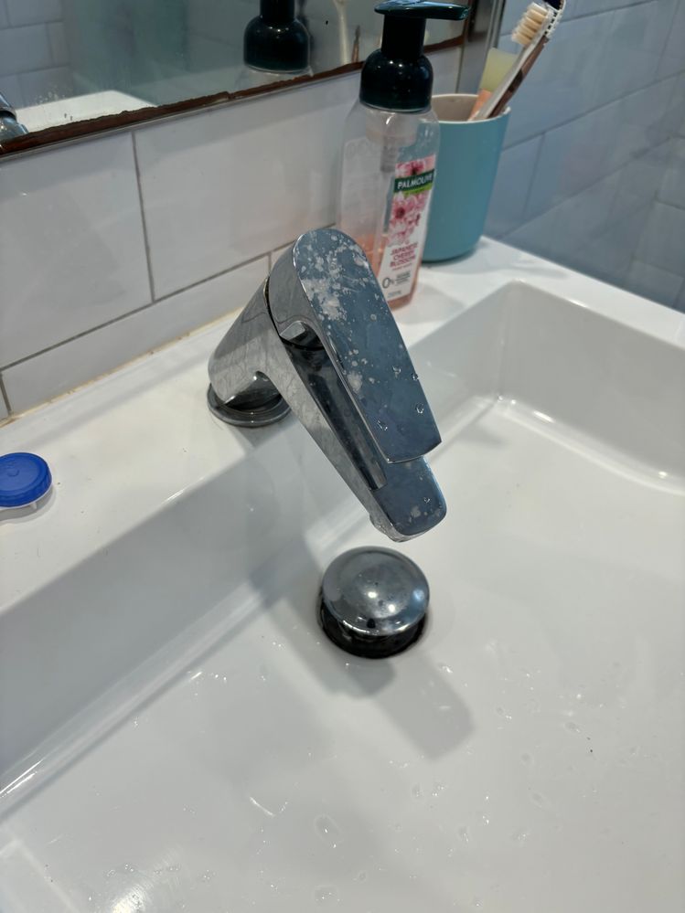

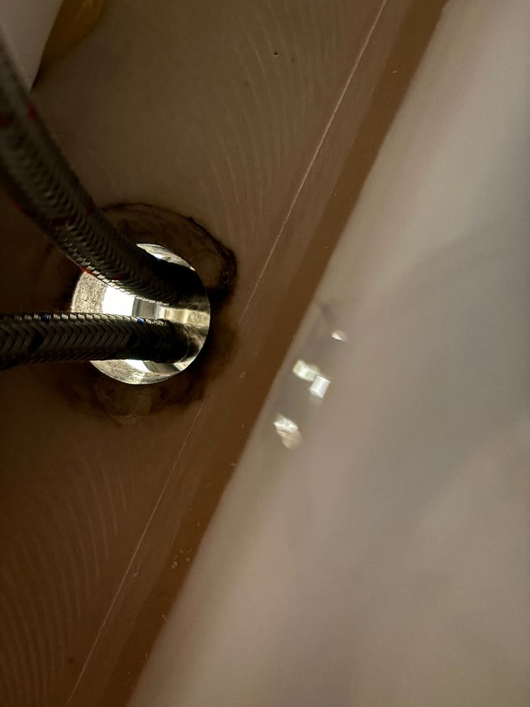

Our bathroom tap has come loose - is there a way to fix it? It's hard to get underneath the sink but it doesn't look like there's much holding it in place above or below the sink?

That tap usually will have a screw on locking nut under the tap from under the basin side. so look for a large dia nut hanging on the hoses. Your one looks like it might screw internally into the body of that tap .
Another possibility is I have seen those locking nuts rusted completly through in the past and destroyed in which case it is time for a new mixer tap of which are not always super pricy.

Thanks for sharing your question about your bathroom tap. Did you find a brass threaded post with a half-moon washer anywhere near the bottom of the vanity? It looks like the Kinetic Mixer Tap Fixing Kit.
The general steps to assembly is to screw the threaded brass post into the bottom of the basin mixer. You then slot in the half-moon rubber washer followed by the galvanized half-moon washer. To hold everything in place there is a brass nut that needs to be screwed onto the brass rod.
I've placed images below to give yo an idea of how it is fixed in place. The tool you'll need to use is called a Magnet Mixer Tap Spanner Set.
