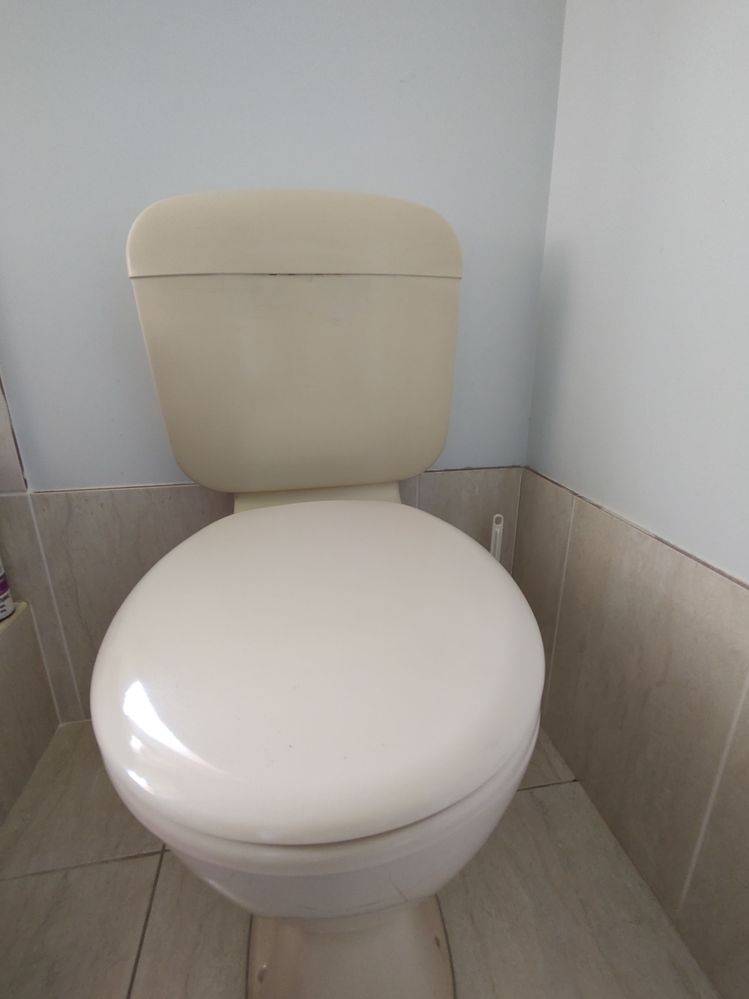

Hi, my ensuite toilet leaks out onto the floor when it is flushed and it looks like the leak is coming from the base of the cistern. After the cistern fills up, the leak stops. I've checked the water inlet valve at the wall and that looks fine.
The toilet is the older style model which came standard when the house was built 18 years ago. I can't see the brand
but from memory I think it's a Caroma.
I'm not a handyman by any stretch but don't want to pay for a plumber if the fix is relatively simple. Any advice will be appreciated.

Would it be possible for you to post a photo of where exactly the leak is occurring? Is it between the cistern and the pan? Is it leaking inside the pan? If it is at the base where exactly at the base? Is it coming from the flush pipe? Any other information you can share about the occurring leak would be very much appreciated. The extra information you provide will allow our members to better diagnose the problem.

If the leak onto the floor only occurs when the toilet is flushed, that indicates to me that the leak is below the cistern. If the leak were coming from the bottom seal of the outlet valve, then it would leak onto the floor continuously whenever there is water in the cistern. This narrows it down to only two possibilities, and they are where the flush pipe is attached to the bottom of the outlet valve or the toilet pan. The flush pipe is the section of pipework that connects the cistern to the pan. If the leak appears to come from the base of the cistern, then I suspect that the flush pipe ring has perished, and you can purchase this Kinetic 50mm Flush Pipe Ring to replace it. You'll need to unscrew the large nut at the top of the flush pipe and remove the pipe from the bottom of the outlet valve to access the ring.
The other end of the flush pipe seals to the pan with a flush cone. These can be replaced too, but they are lower down than the cistern, so it sounds like the leak is not coming from there. If you want to cover all bases, then you can purchase and install one of these Kinetic 50mm Low Level Flushpipe Kits.
