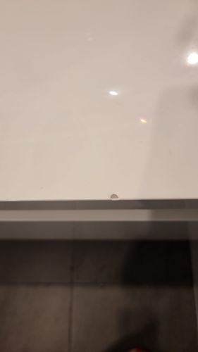

I accidentally chipped the bathroom vanity/sink! How would I go about fixing this? Would rather not pay someone insane amounts to fix this little thing. Any help would be greatly appreciated :smile:

Did you manage to find the chip? If so, you could glue it back in position with Clear Epoxy Glue. If the chip has gone missing, then you'd need to fill the damage with PC-11 56g White Epoxy Paste and then paint the area with White Knight 500ml White Tub And Basin Paint. However, I recommend that you at least have a professional look at this for you and give a quote on repair. Depending on your level of D.I.Y. skill, the above method might not give you satisfactory results. The hard part will be applying the filler. If you apply too much, you'll need to sand it back. Sanding the filler would be quite hard to do without damaging the surrounding benchtop.

The chip is honestly the size of a pea. I don't really want to pay crazy amounts for someone to come out here and fix it. But I also can't not fix it as I'm in a rental.

Please be advised that even a repair done by an experienced tradesperson might still be noticeable. Since you're renting, I'd suggest that it might be in your best interest to report the damage to your property manager. Manufactured stone benchtops can chip quite easily, especially on sharp edge profiles like your vanity. This is obviously not purposeful damage that you've done to the property, and it doesn't take much to damage some manufactured stones. It would be worth having a conversation to find out what the homeowner would like to do.
